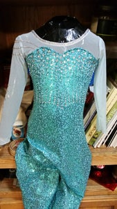

You are nearly done! Now you just need to glue on rhinestones. So many rhinestones. So very many rhinestones. Fortunately, this is the really easy part, and you can do this while watching episodes of Big Bang Theory or Once Upon A Time, like I did.
Map out where you want the bottom point of the bodice to be. It should be directly below the point in the sweetheart shape of the bodice. Then begin applying rhinestones, starting with the big ones then tapering it off to points.
Place a few dots of glue in the spots you want rhinestones to be. Then, using a white eyeliner pencil, a damp q-tip, or a special rhinestone applicator tool if you have one, begin applying the rhinestones. You don't want to put too much glue on, or it will dry before you can get to it. You can begin to get adventurous once you get into the rhythm.
Make sure to allow proper drying time before flipping over and working on the back.
For the sheer top and the sleeves, place the dress back on the dress form. If you have an arm for it, it will come in handy here. Put a sheet of wax paper between the sheer fabric and the dress form, and mark your designs on the dress with a pencil. Following the same procedure as the bodice, apply small amounts of glue at a time and begin applying rhinestones in your designs. Feel free to add rhinestones along the collar. The fabric glue works really well on stretch fabric, particularly if the fabric is stretched a bit when you begin gluing.
Step 10: Showtime!
Now, you should have a completed Elsa dress. All that is left to make is the cape, which is in a separate Instructable. and can be found here: Elsa Cape Instructable
Now you or your tiny human can run around as Elsa (magical powers not included) looking as gorgeous and sparkly as the snow queen herself .
