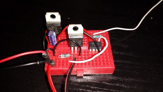

Like mentioned in the intro, the core elements of this part are an Arduino, aluminum foil and a 10 megaohm capacitor.
Then I got a bit stingy and didn't want to use my only Arduino Uno for this. Another instructable caught my attention. For easy controlling an Attiny is more than enough, so this can be used to programm it using an Arduino with the same code tested on the Arduino. The Arduino code is also attatched, nothing fancy. It only monitors the input of the aluminum foil, and brightens the LEDs more if input is found. If no input the LEDs fade away. If the input is long enough, the light stays on. Didn't mention it, I used a simple 12V LED strip with 12 LEDs.
Now I had to extend the layout a bit, because the Attiny uses 5V and the LEDs used 12V. Since I didn't want to use two current inputs, I used a 7805 voltage regulator and two 10uF capacitors. Also because of the 2 voltages, I used a TIP122 transistor to control the 12V LEDs using the 5V output from the ATTiny.
Since I am an electronics beginner I look forward on your comments on mistakes or possible enhancements.

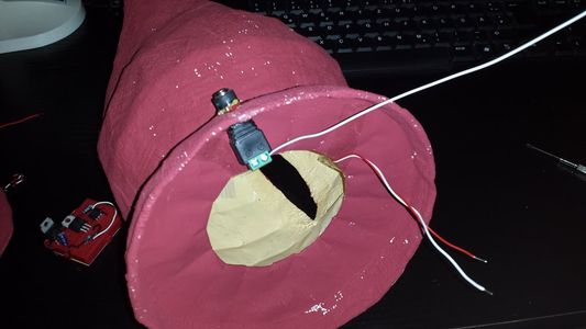

Step 3: Putting It All Together
Almost finished. I used a round peice of wood as the base of the lamp (also good for stability and holding all electronics). The aluminum foil I glued on the inside of the lamp. The same with the LEDs. The little breadboard I glued on the base. I also used an adapter for the current input, and a little power switch at the bottom to completely turn the lamp off.
