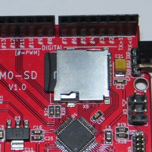

Step 2: Preparation of Analog Arduino M0
As already mentioned, the Analogue Arduino M0 is hardware and software compatible with the original Arduino M0, but it also has an onboard microSD connector for connecting a memory card.
To connect the camera to the Arduino M0 Analogue on the board it is necessary to solder the angular connector to the terminals TXD, RXD (connector X6) as shown in the figure. This port matches to the "Serial".
White (Camera RX) and yellow (Camera TX) wires from the camera must be connected respectively to the terminals of the TXD and RXD (connector X6) as shown in the figure.
You must insert a memory card (at least 32MB) formatted in FAT32 format into the microSD slot.
