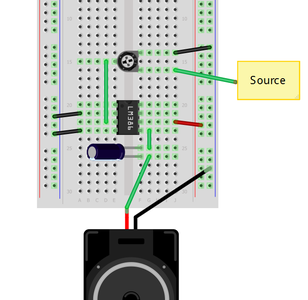

Audio Amp
You can connect the Propeller Platform directly to the speaker in Rudolph's body, but the audio will be very quiet. So you'll need to amplify it to be heard. I've built the amplifier using an LM386, a common small audio amp. Here's how you connect each pin on the LM386;- Pin 1 (the pin closest to the notch on the chip) is unconnected
- Pin 2 is connected to ground
- Pin 3 is connected to the audio source, usually through a potentiometer so you can turn the volume up and down
- Pin 4 is connected to ground
- Pin 5 (diagonal to Pin 1) is the audio output. It connects to the speaker through a capacitor)
- Pin 6 is connected to the power source - 5V in this case
- Pin 7 and Pin 8 are unconnected
