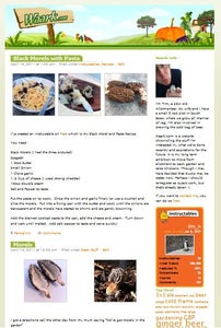

Step 3: Style the Website
Make the script generator look good!

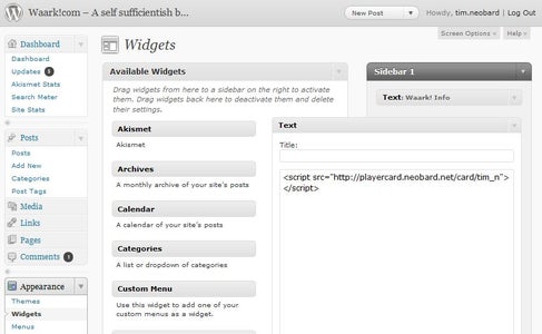

Step 4: Putting the Code on Your Site
Cut and paste the code into whatever section of site you want to display your player card!
In the case of wordpress, add a text widget and paste the code generated on the http://playercard.neobard.net site!
