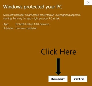

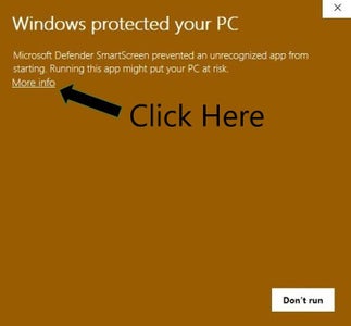

The EmbedUI - Windows Application is currently not signed. Due to this Windows Smart Screen blocks it. However, this won't affect any functionality of the application.
Being an open-source project, it is difficult to get the Application signed due to its high cost. Suggestions & support are always welcomed. I would appreciate suggestions for a workaround on this.
Coming back to the point, it's a one-time approval that you need to provide to the installer of the EmbedUI Application while you install. Refer to the attached images for more info.
