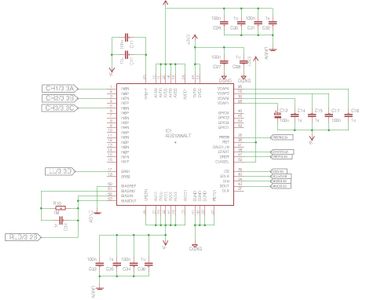

Step 3: The Design of the Analog DAQ and Supply Board
Since I had the ZYBO dev board, I had two options for DAQ:
- I could've used the on-board XADC with an external analog signal conditioning board. The advantages: with the instrumentation amplifier and opamps I could've integrated analog filters in the circuit filtering out the noise before amplification. The disadvantage was the resolution of the ADC: 12bits, which is a minimum in biopotential measurements.
- I could've used an external Analog Frontend chip which is designed for biopotential measurements. This is the path I took. I've chosen the ADS1299 Analog Frontend IC from Texas Instruments, which has circuit protection, 8 programmable gain amplifiers (x1 - x24), 8 delta-sigma modulated ADC-s with 24bit data resolution, and sampling frequency from 250SPS to 16kSPS.
The board design is the minimal setup based on the recommandation in the datasheet.

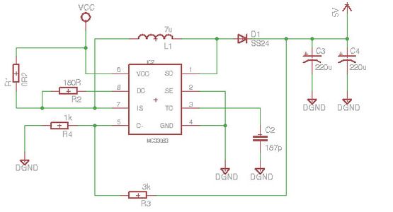

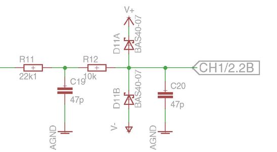

Since the ZYBO board is supplied with 5V DC, the ADS needs +2.5V, -2.5V and 3.3V, but my batterys output voltage was 4.2V when fully charged, power converter circuit was necessary for the supply. The power efficiency is a key factor in battery operated circuits, so the use of DCDC converters was inevitable.
The first step in a power supply design was the polarity protection. This could be done in a series diode, which would let current flow only if the polarity is rigth, but the diode has a small amount of voltage drop. Another possibility would be with an anti-parallel diode, and fuse combination, but this requires 2 components. Yet another possibility is using a transistor as low- or high-side switch. I've chosen the MOS-FET based high-side switch with low on resistance transistor. The high-side switch was used because when off, there is no voltage in the circuit.
The battery voltage was Boosted to 5V with a Boost DCDC converter. This supply was used to power the Soc board, and for generating the positive analog suply. The analog supply was generated with a LDO linear power supply. The negative supply was created with an inverting Buck-Boost converter. Both DCDC converters were designed based on the MC33083 driver ICs datasheets recommendation.
While using switching mode power supplies one must be cautious of the generated noise, especially in a signal acquisition circuit. I made sure the noise was on an acceptable level by designing the converters to work on 50kHz switching frequency, while the sampling frequency of my ADC will be less or equal to 2kHz. Even though we can be certain the circuit will work correctly based on the Nyquist criteria, I measured the AC to DC ratio, and it was under 0.02%.
The 3.3V supply was used from the ZYBOs PMOD supplys.
With these considerations in mind the DAQ board was designed in EAGLE cad,

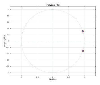

Step 5: Signal Processing Theory
The signals recorded from the human body are contaminated by noise. The noise contains low frequency components like muscle movement noise (EMG), baseline wandering (from the slow changing of the skin and electrode properties), but high frequency noises too, like the 50Hz mains noise, RF picked up by the cables etc.
To remove these noises, filters must be used in the circuit. The filters can be realized with hardware – has the advantage of filtering out the noise before the amplification stage, or in software – FIR filters can be applied with linear phase response, to cancel distortion.

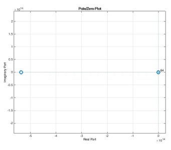

In ECG measurement specification a 0.05 Hz to 200 or 250Hz band is advised with mains frequency removed or damped. I didn’t implement the high-pass filter, because the baseline wandering and other low frequency noises can be removed with an on-line polynomial fitting algorithm.
The used low-pass filter was a 64thorder Taylor windowed FIR filter with 1kHz sampling frequency.
For the band stop filter I chose an IIR filter, because at lower order it can achieve the same results as a high order FIR filter.
Both of these filters were designed in Matlab, with FDA tool.

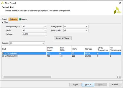

Step 6: Internal Hardware Design
In this step I focused on the hardware design in the Zynq SoC.
- A new design is created with the hardware present on the board ( XC7Z010CLG400-1).
- A ZYNQ ARM processing system is used as the main device ( Alternatively MicroBlaze can be used in case of FPGAs - but this will be covered in another instructable). The base configuration can be downloaded from the Resource Center

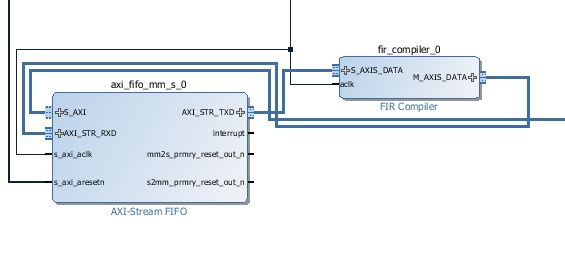

For now I added only a FIR compiler IP for testing purposes, but the filter will be replaced later on with IIR + FIR versions made in HLS.
In order to work with the FIR Compiler IP, an AXI Stream block must be added to the system with matching or larger data width ports. The FIR coefficients were saved from the FDA tool to a .coe file in hexadecimal, 16bit signed integers.
With this we made a hardware ready for the inicial test of the bare-bone Core containing the acquisition software, and for the Core with OS on it. The only step to make is to generate a bitstream and import the design to SDK.

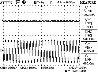

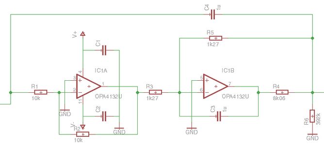

Step 9: Analog Filter Stage
After doing some tests on the system, I came to the conclusion that the noise level is greater than the signal level. Using only the amplification and the software filter would only cut out a small part of the noise, but it would also cut out some of the useful data.
The solution to this problem is to use an analog filter before the PGA. As we saw in the previous steps, two filters must be implemented, a 50Hz bandstop filter for the mains noise, and a 250Hz lowpass filter for the high frequency noise (and anti-aliasing).
The Bandstop filter design:
A second order bandstop filter was designed based on the filter transfer function Hbs = H0(s^2 + w^2)/(s^2 + (w/Q)s + w^2), w = 2*pi*fc, and Q = fc/(fb), where fc is the center frequency, fb is the stopband width, H0 is the gain.
Since the purpose of the filter is to cancel out the noise, and not the amplification, H0 = 1, fc = 50Hz, fb = 2Hz. For the implementation a modified Bainter-topology was used as shown in the second picture. The Bainter-topology has the advantage of matching independence ( the Q factor of the filter only depends on the gain, not the resistor matching opposed to the Sallen-key).

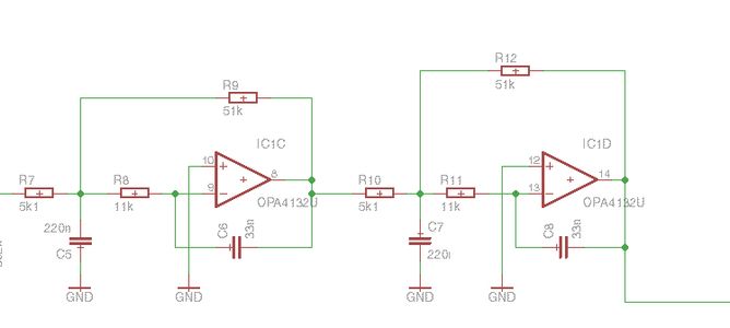

The Lowpass filter design:
A forth order lowpass filter was designed with two second order filter stages: Hlp = H0*w^2/(s^2 + 2*e*w*s + w^2), w = 2*pi*fc, where fc is the cut-off frequency and e is the damping ratio. I've chosen a filter with H0 = 1, fc = 250Hz, e = 1 parameters. The chosen filter type was the multiple feedback topology (MFT). The MFT LP filter is prefered, because it has high Q factor, and narrow pass-band relative to the Sallen-key topology. The only drawback would be the inverted output signal, but I used 2 stages, so this wasn't an issue.
A swept sine wave input was used to test the overall behavior of the filter (last picture).

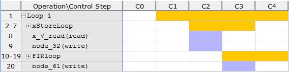

Step 11: Using the Filters From HLS And/or the FIR Compiler
Since I had prior experience with filter construction in C/C++, I chose the Vivado HLS program to implement the filters.
The filter function should have a header as follows:
void function (<data_type>* input, <data_type> *output, <data_type> *coeffs)
First let's have a look at the function arguments. What data type should we choose? If this would be part of a PC program, then data types wouldn't be much of a concern (we could choose double or float), but we want to synthesize to hardware, so data width IS a concern. The ADS1299 datasheet specifies the exact data type: signed 24b data (2s complement), so it would be a waste to use 64 or 32b floating point data.
Fortunately HLS has a header just for this job - "ap_int.h" contains custom width integer and fixed point data types.
Now to the last part, the coefficients. The coefficients were generated in Matlab, and will be used in HLS. If the coefficients are specified only once, we can specify them as constants at the start of the function. If we want to change the coefficients we can leave in the arguments, but the storage must be a dual port RAM/ROM type since the optimisation requires it.
The first digital filter will be a 65 point FIR filter.
const int firlen = 65; const int dWidth = 24; typedef ap_fixed<dWidth + 4, 4> fir_t;<br>
The fir_t type will be used for fixed point data type. We need a storage register for the input data, a temporal register, and a storage register for the sum of products.
fir_t xStore[firlen]; ap_int<dWidth + 4>tempX; ap_fixed<dWidth*2,dWidth-8> sum;<br>
The sum register must have a size that can handle 65 24b*24b values sumed.
We need to define the filter coefficients as ( the values can be copied from Matlab):
fir_t coeffB[firlen] = {...};In an infinite loop we store the input values, convert them, and proceed to the MAC operation.
while(1){
for(int i = 0; i < firlen - 1; ++i)
xStore[i] = xStore[i+1];
temp = (ap_int<dwidth +="" 4="">) *(x++);<br></dwidth> xStore[firlen-1](dWidth + 3,0) = temp(dWidth + 3,0);
sum = 0;
for(int i=0; i < firlen; ++i)
sum += coeffB[i]*xStore[(firlen - 1) -i];
Last but not least we need to convert the fixed point value to signed integer in the loop.
temp = fir_t(sum).range(dWidth -1,0); *(y++) = (ap_int<dwidth>) temp;</dwidth>

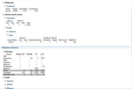

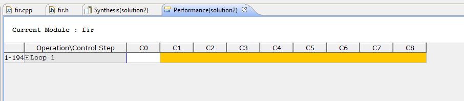

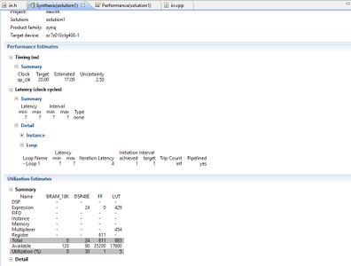

Now it's time for C synthesis. We can see (Figure 1) that just a small amount was used from the resources, and the estimated timing is 15.33ns. We can optimise the filter by pipelining the storage and MAC loops with
#pragma HLS PIPELINE II=1
Similarly, the IIR filter can be made.

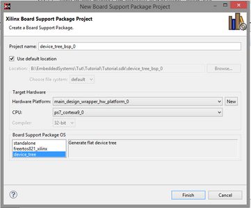

Step 12: Building Linux for the ZYBO Dev Board

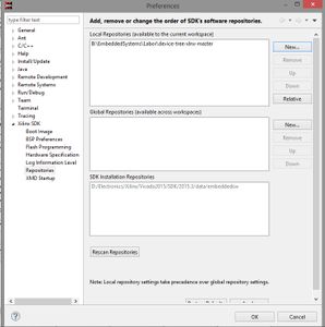

On a Linux OS some files are needed for the embedded operating system: a device tree folder
The unzipped folder needs to be copied to the SDK directory. In Xilinx Tools/Device Repositories add the location of the device tree folder. Next step is to create the device tree files. Under File/New create nem Board Support Package and choose the device-tree option. Note the core name. It doesn’t matter which core you use, but use this core for all the projects (the ARM in ZYNQ is a dual core MPU). From
the generated files copy the pl.dtsi, skeleton.dtsi, zynq-7000.dtsi and system.dts files to the Linux platform. Open up the system.dts file and replace the &gem part with:

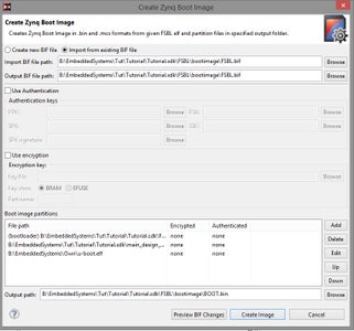

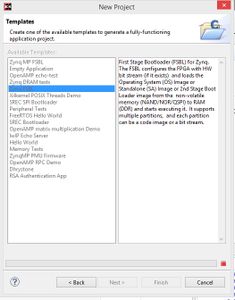

In order to create the boot Image file, I need to build the Xilinx uBoot file.
Running make zynq_zybo_config will create the .config file, and running make will build the output in the src
folder. In SDK go to Xilinx Tools/Create Zynq Boot Image. The FSBL.elf must be added as bootloader file, the design_wrapper.bit as data. uBoot file should be renamed to uBoot.elf and added to the files. The order of the files is importan!

make ARCH=arm UIMAGE_LOADADDR=0x8000 uImage.
In Linux I need to build a ram disk image by executing the command:
mkimage –A arm –T ramdisk –c gzip –g ./ramdisk8M.image.gz uramdisk.image.gz
The last step is to copy all files to an SD card: the files needed are: BOOT.bin generated from the FSBL process, devicetree.dtb, uImage – without the elf extension, and the uramdisk file, all of these files will be copied to a small FAT32 partition on the SD card, an ext4 partition is needed for the file storage system ( if this partition is not used, the Linux will work only on the RAM, so for this partition I used an ARCH Linux file system).
