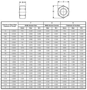

Step 1: Measure Hex Nut
First you must measure the hex nut you plan on using. If you do not have calipers a quick google search will give you a chart and you can find the dimensions you need.

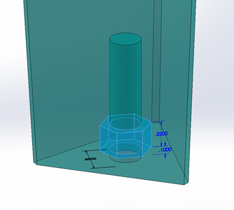

Step 2: Add Cavity in Your 3D CAD Design
Here is an example of clearance for a 5/16-18 hex nut. I like to space my hex nuts about .100" from the surface. I give the hex nuts about .015" clearance per side for a light press fit (but that may differ with your printer).
Lastly, make sure to give plenty of clearance for the bolt to screw threw the hex nut.

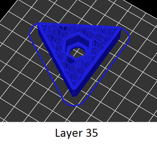

Step 3: Slicing and Printing
After my slicing program is complete I look through the layers and determine the last layer before the cavity is closed up. In my example layer 35 is open and 36 is covered up.
From here I can either manually pause the print during layer 35 or I can insert a G-code text to pause and move the printer head.

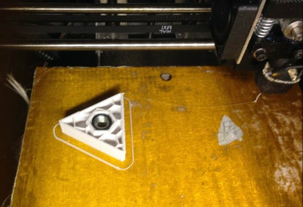

Once paused I insert the hex nut and resume the print.

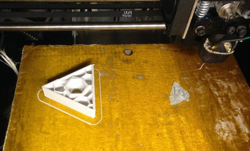

Step 4: Complete
Now you have a 3D printed part that can accept a threaded bolt

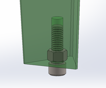

Step 5: Strength Analysis
Thanks for the comment stechi! I decided to put a little thought into the strength of hold this technique can yield.
First of all, I think there are at least (2) types of part mating we need to consider for strength analysis.
-OPEN MATE:
In this case the first thing to consider is how much space (Distance D) the printed part is spanning. I have not done any real tests, but I would guess at around 3.0" and larger tightening the bolt would warp the outer wall of the printed part and possibly break through. I think adjusting the print settings for wall thickness (T) and the infill % would help aid in the strength of this mate.
-FLUSH MATE:
In this case the thickness (T) is sandwiched between the hex nut and the mating part. Minimal thickness is acceptable (too thin and you may see the hex nut's shadow). I have found the weakness of this mate (this would apply to the Open Mate) is torquing the bolt through the "interior perimeter thickness". Adjusting infill % helps aid in strength, but I have found adjusting the number of interior perimeter layers is most effective.
I do not have any torque wrenches to do a real test and I would be interested to see some results, but I can say they hex nuts hold pretty well with basic print settings. I would guess I can tighten the bolts around the same torque it takes to open a beer bottle before I hear cracking plastic.
