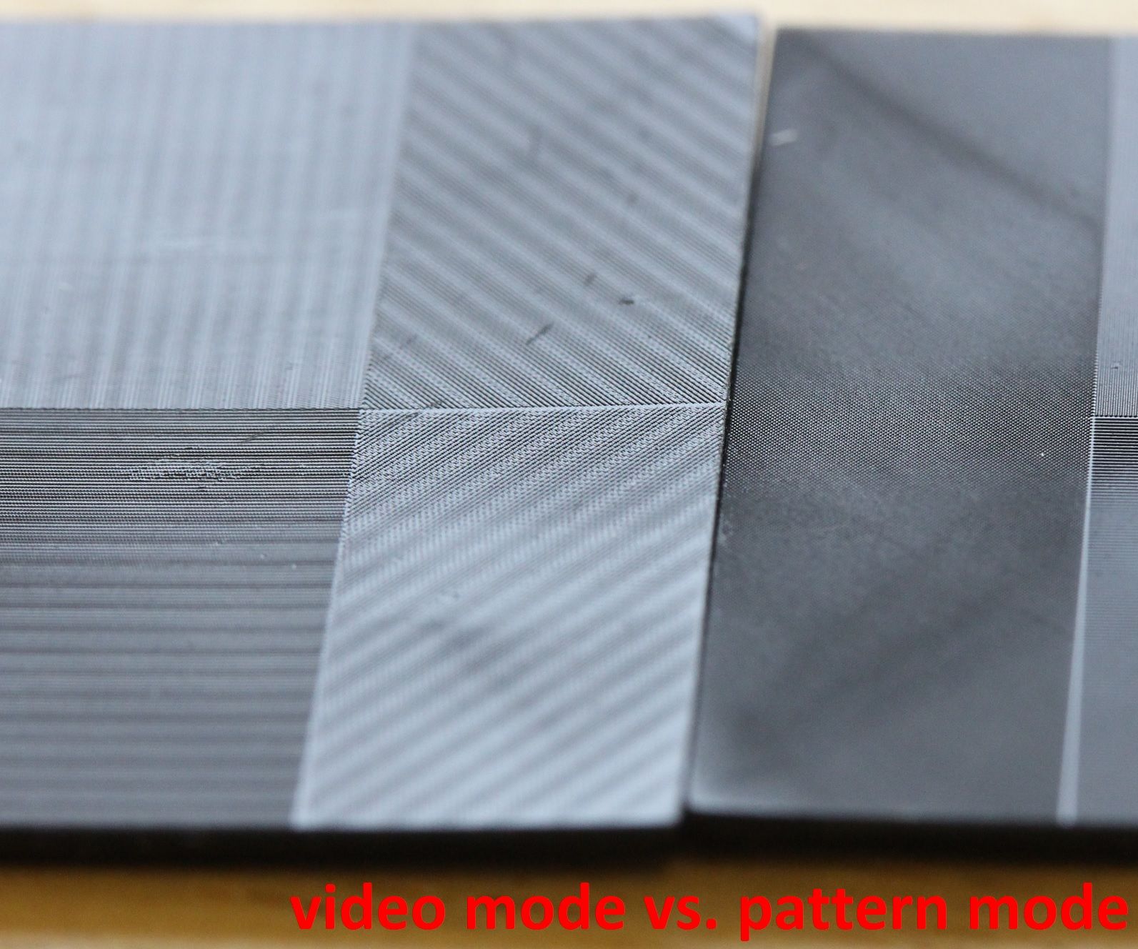

Once you have a bitmap for a bar code, it needs to be processed further for printing by Ember in a single color of resin. That's because the white and black areas of a slice image both correspond to flat planes in the print itself. The white areas will print a new layer, but those regions will be no more reflective than the parts of the previous layer left uncovered by the black parts of the slice. We instead use texture differences to create a high-contrast 3D printed bar code.
The attached processing sketch takes a bar code bitmap as generated in the previous step, and turns it into a slice image in which the white areas are represented as textured regions that reflect more light (under oblique illumination) than the flat, smooth regions left by the black areas. It generates three copies of four different sizes of printed bar code (as shown above) ranging from ~4 mm down to ~1 mm square, using different approaches to provide the texture/contrast difference.
In the larger ones, the white regions are represented by a single-pixel checkerboard pattern. In the smaller ones, the white cells are represented by solid blocks, either 2x2 pixels or 1x1, but they're separated from adjacent white cells by single pixel gaps, allowing them to reflect light from all four edges. However, the smaller ones are also less tolerant of errors in printing and illumination, so the larger ones are preferable when there is room enough.
Both approaches require the use of pattern mode, because in video mode, aliasing artifacts will keep the single-pixel checkerboard from being printed as a uniform "white", and the single or double pixel blocks from being printed with a consistent size.

Two layers at 25 µm works well, since Ember's voxels are nominally 50 µm wide. Again, pattern mode must be used to achieve a uniformly "white" texture, and/or to reproduce the fine details in the smallest versions of the bar code.
The attached print data file simply prints the example bar codes from the previous step on a rectangular base plate that's 1 mm thick. It uses the settings for PR-57 black, at 25 µm, so the bar codes appear in just the last two slices.
The photos above show the final print under oblique illumination by spot lights, except for the one labeled as having used a ring light.
