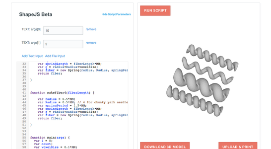

Head on over to http://shapejs.shapeways.com/ and click on "Try it Now". This will take you to a screen where you'll see a snippet of code and an example geometry. I found that orienting myself with this code helped with my project.
A great starter project is working on an individual fiber as you can see above. Either copy the code featured, or work with the documentation to explore on your own. Play with voxel size and args to see what's possible!

Easy to manipulate once you're used to the library. The documentation was a but tricky to follow from time to time, but overall, I was able to get running pretty quickly!
Cons:
Timeout for models is 3min with ShapeJS, so it can be a bit a tricky to render large geometries. I would suggest not running any other tabs or programs while rendering to take advantage of your computer's memory.

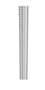

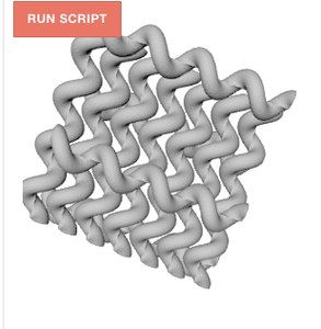

Now that you've gotten your feet wet, let's get helical. By using a helical shape for each individual fiber, we can achieve a bit more flexibility. When printing this in resin (which can be somewhat brittle), this allows a bit more malleability with the material.
In ShapeJS, creating a helix or a spiral is a matter of using the spring function. See the code snippets above to see how changing spiral period and fiber size effect our outcome.

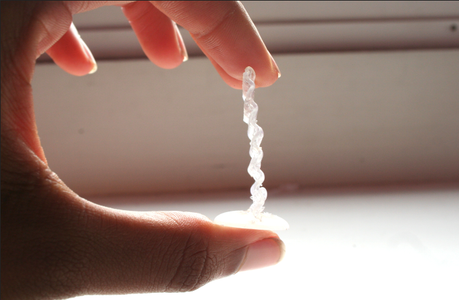

The final swatch and fibers came out to be fairly flexible and resilient for resin.
