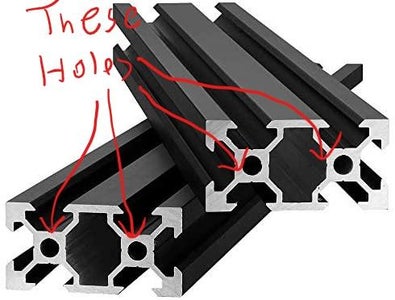

I used some angle brackets to attach the old 2040 rails to the underside of the Y-axis rail, then prepared the base so I could fasten this rail, the Z-axis rail, and the short piece connecting the two to the base using T-nuts and screws coming up through the bottom. The Z-axis rail is attached to the base plate using M5 screws going into two tapped holes in the end of the rail, exactly like how the original Z-axis rail was tapped topside for the handle mount. These holes weren’t tapped in the new rails, but luckily my tap and die set had an M5x0.8mm tap, so I tapped every one of these holes in all of the rails (these also work great for fastening angle brackets).
