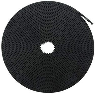

The timing belt was 6mm in width, with a 2mm pitch (space between the teeth of the belt). Unfortunately, I needed just a bit over 1m of belt, which meant I would have to buy 2m as that was the next increment. I briefly considered getting some nice Gates belt, but decided to get the cheaper stuff until I knew I the design was right and tweaked to perfection. The cheap stuff was ~$10 for 5m, which was less than the 2m of the Gates product, so I’ll be fine to experiment with this stuff (SIMAX3D GT2 timing belt, found on Amazon). Estimating belt length was just a simple matter of measuring top and bottom of where they tracked and adding about 40mm for pulley wrap and to have a little extra to clamp with zip ties.

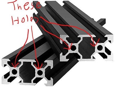

The Z-axis rail is attached to the base plate using M5 screws going into two tapped holes in the end of the rail, exactly like how the original Z-axis rail was tapped topside for the handle mount. These were not originally tapped on the rails I purchased, but luckily my tap and die set had an M5x0.8mm tap, so I tapped every one of these holes in each of the rails. This also allowed the use of the angle brackets to attach the lower 2040 rails to the Y-axis rail. If you have never used a tap before, you need to take great care to start the tap into the hole as straight and square as possible. Thread in slowly until the tap is in a few threads while ensuring you’re going in straight, and back out ½ turn before resuming, and backup often (roughly every turn and a half or two) as you proceed with the tapping.
