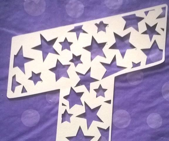

To create a custom design, we’re going to cut the design out twice from a medium weight cardstock and glue together. Because of the small, non-connecting pieces in my design, I’m using a back piece of cardstock to glue everything to. For your first time, try using a simple pattern. Make sure to let dry fully (unless you would like to use your pattern as a backing, see step 4)
If you have die-cuts, you could use those as well. You could also use one thin layer of cardboard, although that might be trickier to cut out.
After cutting and gluing, you might feel like this was a lot of work and wouldn’t it just be easier to use the leftover cutout version. I’ve done a side by side comparison in the next step of this way—the impression comes out crisper with the raised version, but may be appropriate for what you’re going for.
