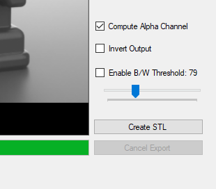

This method prevents the problems from the previous step, mainly the sharp edges of the template. Generally, for such an operation, the howtos from the net recommend the use of 3D editing CAD program, these programs are difficult to use, to learn and the really good ones are not open source softwares. I have found that the easiest method is to use an image editing program, such as Paint.NET. After editing in Paint.NET I transformed the resulting image into a three-dimensional object with the help of ImageToSTLConverter. The transformation is based on a simple rule: the black color is the zero level, the lowest height of the object (the zero level) and the white color is the maximum height of the object, the height that you define (in my case 2 or 3 mm). Otherwise, all shades of gray (253 maximum) are intermediate heights. You can watch in the videos below what it is exactly about.

· Opening, filling with white where necessary, enlarging the canvas, reversing the image (highlighted areas = white, base area = black), selecting the white areas and applying the Gaussian blur effect, deselecting and applying a new blur, saving - in Paint.NET;
· Import into ImageToSTLConverter, generating and saving the STL file;

Attached, you have the floral model STL file and photos with the templates printed on the 3D printer. As you notice, the edges of the model are beautifully rounded, so the reliefs can also be made with thinner metal foils. I made positive and negative templates, the difference is when the STL file is generated the "Invert Output" option in ImageToSTLConverter is deselected.
