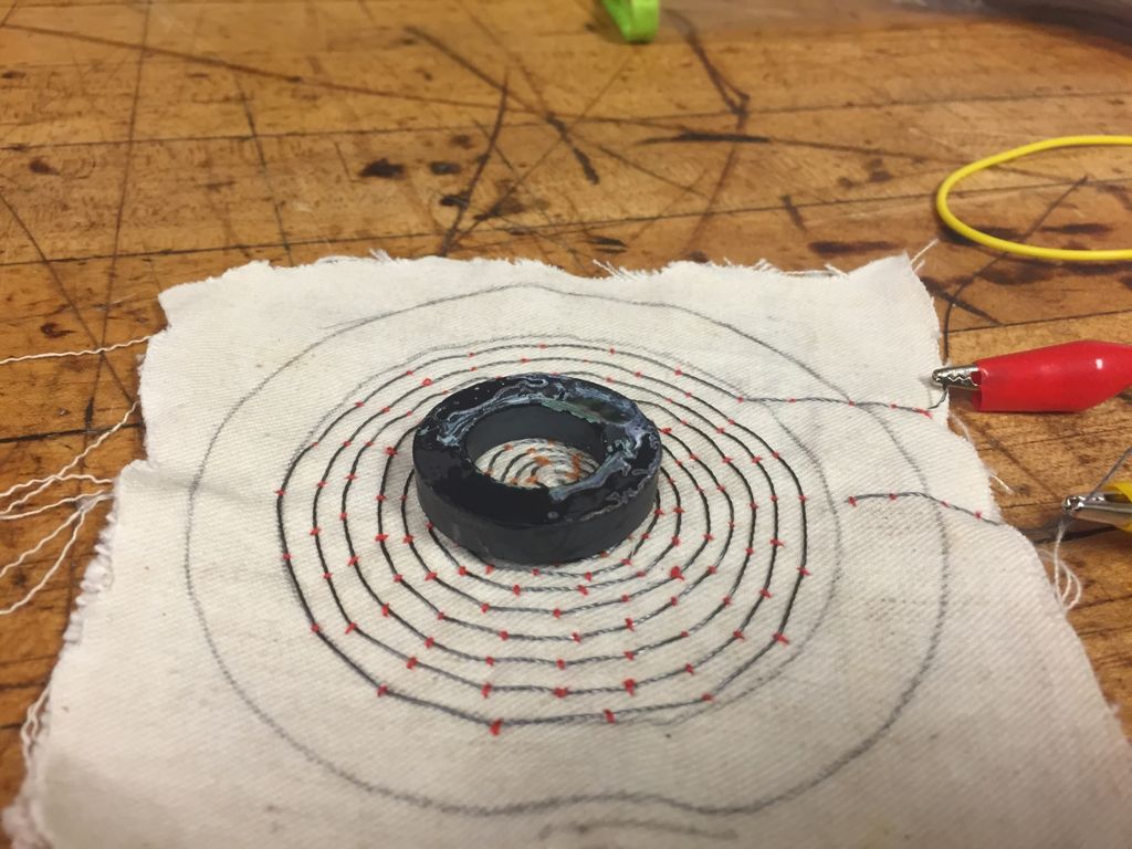

Step 3: TRACE AND FUSE
Iron a square of fusible interfacing to the back of the piece of fabric that you plan to embroider your speaker coil on. Peel the paper backing from fusible interfacing and trace the outline and mark the center point of your coil on the front of the fabric.
Fusible interfacing is a heat glue that bonds two pieces of fabric together, adding stiffness to the material. The reason it makes sense to stitch your speaker coil onto stiffer fabric is because it will help keep the fabric taut as you sew so that the coil will not start to collapse the fabric back on itself.
Either before or after sewing your speaker coil, use an iron to fuse your membrane to another piece of fabric, or an item of clothing, or your project - wherever you want the fabric speaker to go. Having multiple layers of fabric fused together does make it harder to sew, but it also makes for a stiffer membrane that is better at moving air.
Step 4: START SEWING
With a sewing needle pull the end of your conductive thread through the center of your coil so that the needle ends up on the back side (with the fusible interfacing). Pull as much thread through as you will need to connect the center of your coil to your circuit. Generally 10-20 cm is good. Then remove the thread from the needle.
Step 5: COUCHING
Thread the needle with regular thread and tie a knot in one end. Insert from the reverse side through the center point of your coil design. Stitch over the conductive thread and back into the fabric, then come back through the fabric a few mm further along your coil path. This embroidery technique is called "couching".
Step 6: KEEP SEWING

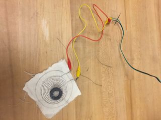

As you are sewing your coil from center to edge, you want the conductive thread to come as close as possible to the previous turn without touching it. If one turn of the conductive thread touches another then the electricity will not be forced to flow around in circles, which is what increases the strength of the magnetic field.
Step 7: ADD MAGNETS
For a quick first test of your speaker simply clip on two magnets one on either side of your coil, so that they hold each other in place. If you have a smaller magnet, then place this one on the front side, since the magnet is conductive it will otherwise short out your speaker's coils. You can also put a piece of fabric in between the magnet and the coil to isolate it. For your final design you will want to mount your magnet(s) in the center of the coil without having them directly connected to the membrane.

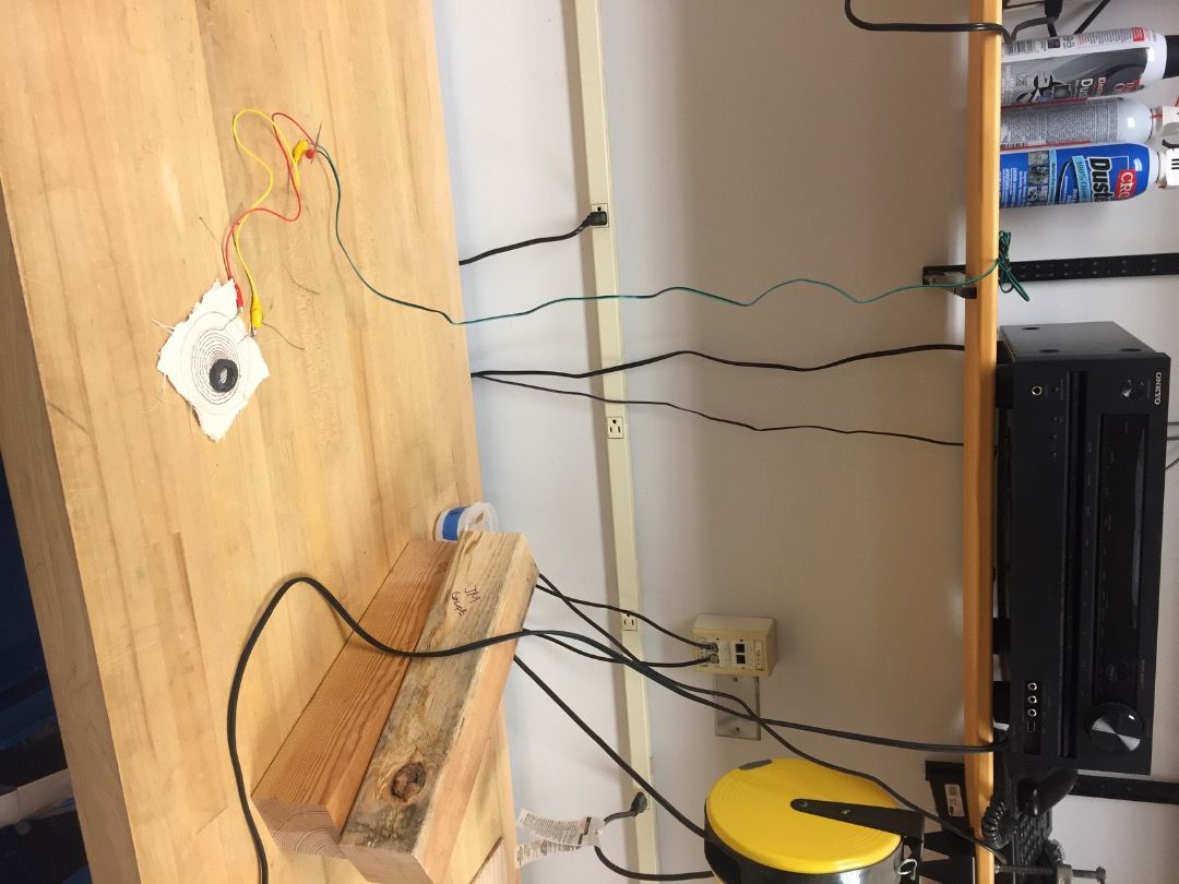

Step 8: HOOK UP YOUR SPEAKER
Connect both ends of your speaker coil to your amplified audio signal. If you can not hear your speaker, try holding it very close to your ear. If it is very quiet then it is working, but you might need to increase your power source or reconsider your coil design to make it more efficient at moving air, which is what makes it louder.

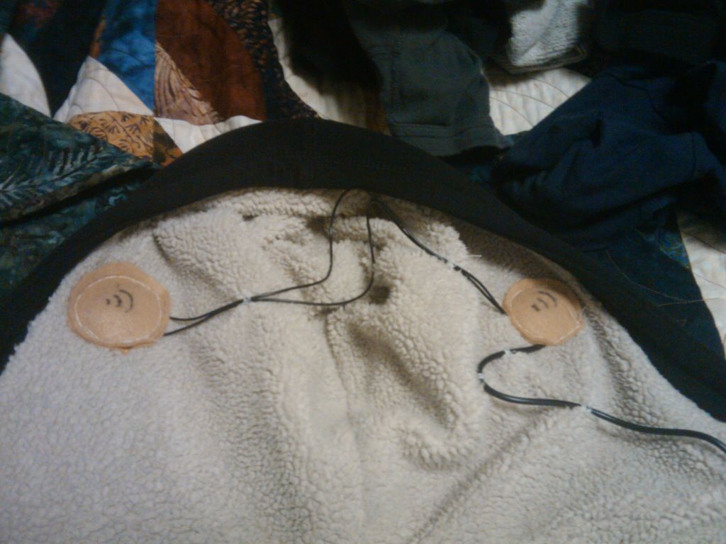

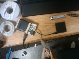

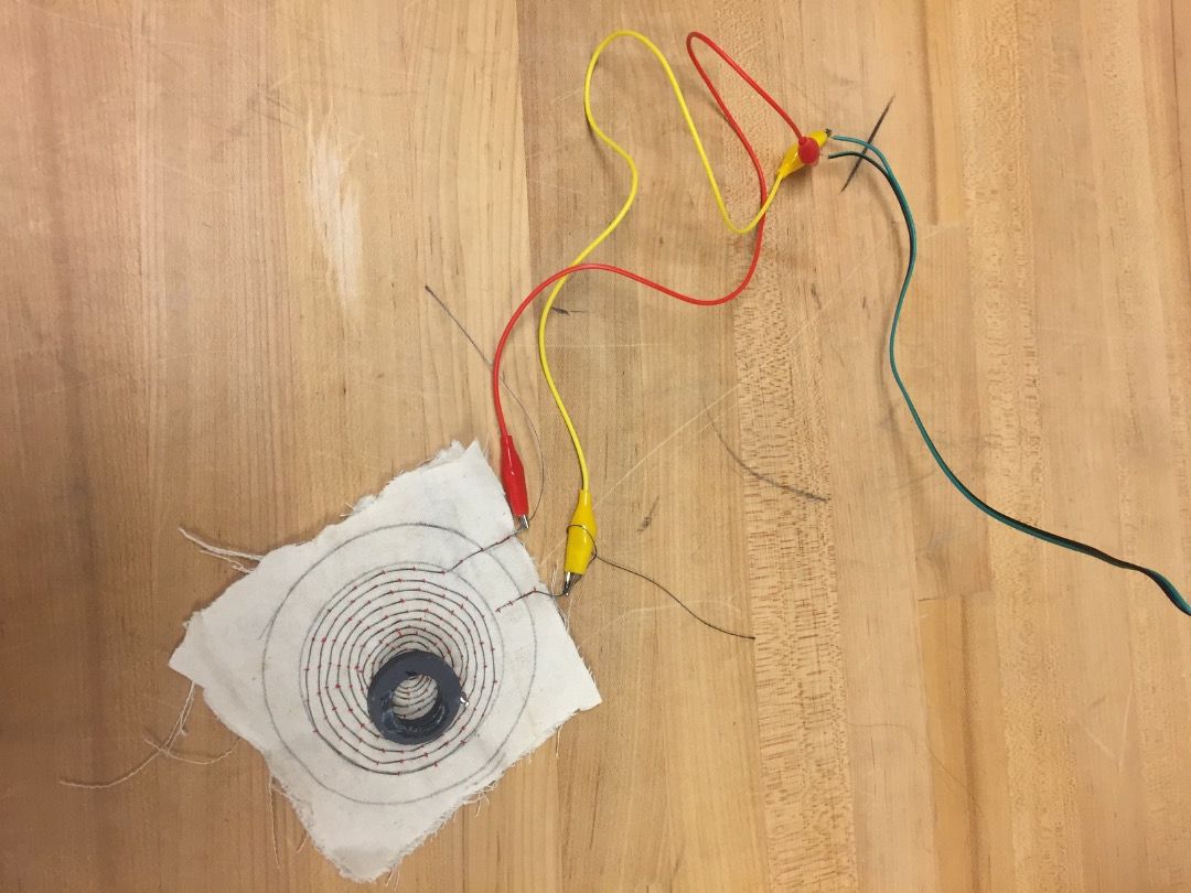

    So I made two of these and embedded them in my hoodie! The sound quality isn't great, but it's still cool!
    IMG_20121209_133030.jpgIMG_20121209_133100.jpgIMG_20121209_132928.jpgIMG_20121209_132913.jpg
    0
    Plusea
    Plusea
    Reply 8 years ago on Introduction
    Oh cool!!! Thanks for the photos! It looks great.

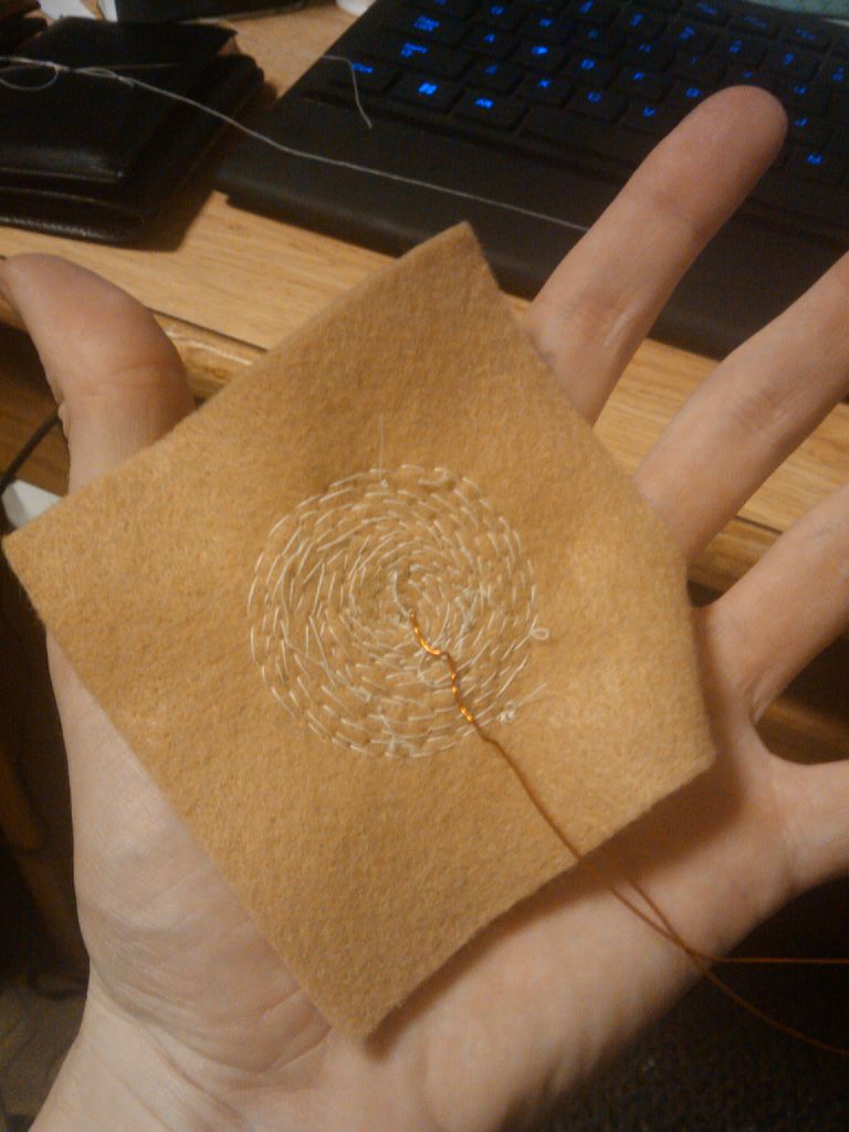

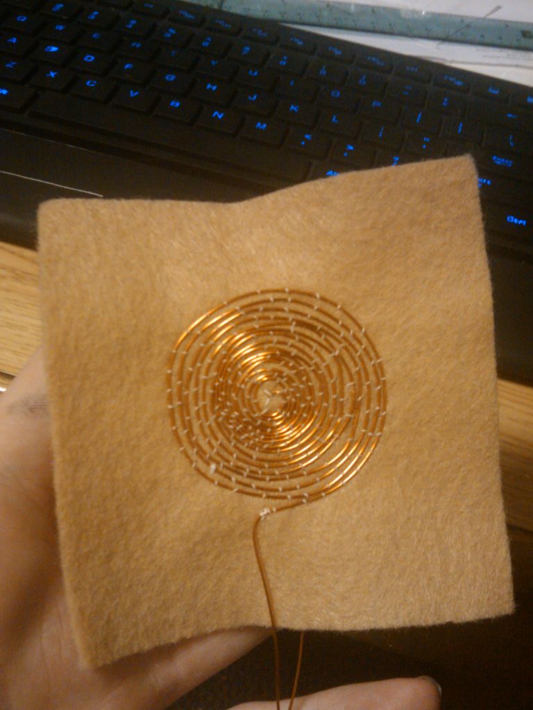

    Made a version with magnet wire on felt. Waiting on some magnets to test it out.

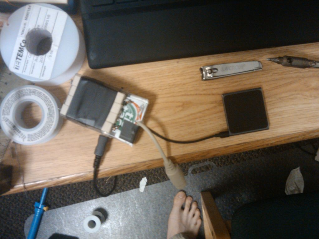

    you're right the black speaker sounds best, but it's not just the speaker it is also the audio source. for the black speaker the audio is coming from an mp3 player and being amplified by a commercial amplifier, but in the other videos the audio is coming from a cheap sound circuit found inside greeting cards and i am amplifying it with a transistor.
