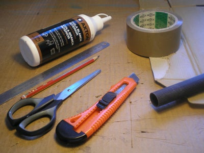

Step 1: Materials and Tools
You need:
- Cardboard 30 cm x 36 cm (medium or thick).
- Tube -coming from old dustpan- (if you don't have any, always you can use it without).
- White glue.
- Box tape.
- Ruler and pencil.
- Scissors and cutter.
- Cutting mat (I'm using thick cardboard).
Also some clothespins will help later.

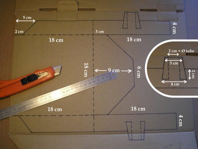

Step 2: Cutting and Scoring

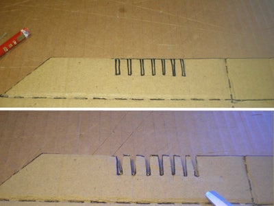

Cut one piece of cardboard as shown in schema. Solid lines are for cutting, dotted lines for folding.
The diameter of my tube is 2 cm, you must adapt both detailed sections to yours.
Score dotted lines helping with scissors or cutter.
Finally, draw some teeth in one side and cut them with scissors.

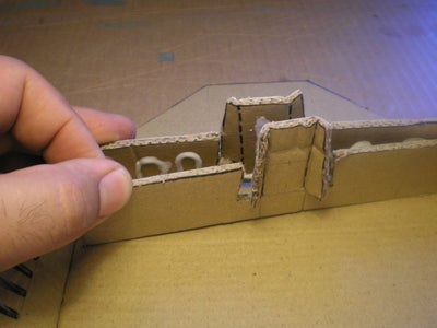

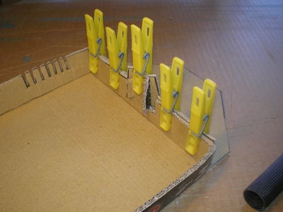

Step 3: Folding and Glueing

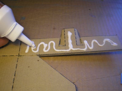

Fold by dotted lines and then glue both wings, taking care not to glue flaps. Clothespins will help now. Wait to dry as product indicates.

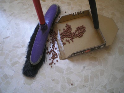

Step 4: Finishing

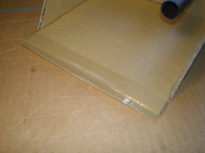

Now, cut a piece of tape and put on on the edge, taking care it must protrude a little (this helps collecting dust).

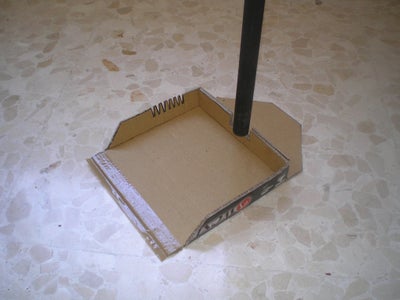

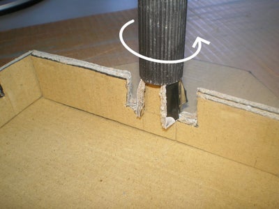

Put on the tube carefully, with circular motion. If the cardboard doesn't support its weight, I suggest you to reinforce it glueing a rear piece of cardboard and some tape.
Remember to recycle cardboard when not using any more, removing tube and tape.

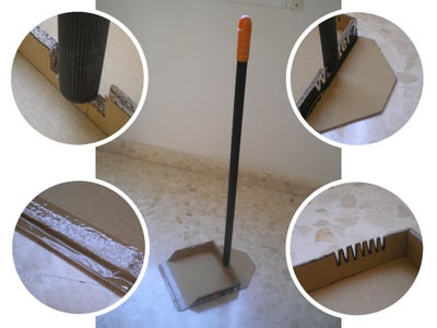

Work is done!
