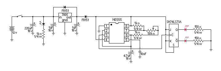

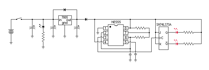

Step 1: The First Circuit Evolution
It wasn’t long after starting and I realized the circuit would need a voltage regulator for the JK Flip Flop, 12 volts is fine for the 555 timer however the JK Flip Flops I have in stock run on 5 volts.
To the circuit I added an on indicator LED, LM7805 voltage regulator and high speed diodes to isolate and protect the circuit from power surges and feedback.

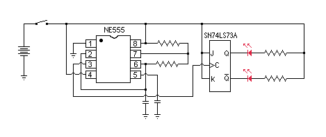

Step 2: The First Prototype
In the first test prototype I skipped the on Indicator LED and the on switch and after numerous calculations came up with values for the resistors and capacitors to be tested. A switch to turn on the LEDs without flashing was impractical so I came up with speeding up the flashing until the LEDs look like they are on all the time so I added a 50 k Ω pot to the 555 timer circuit. This circuit will function as desired whether it is connected power through LEDs to JK flip flop or flip flop to diode to ground.

Step 4: Then Test the Circuit.
I assembled the circuit on a breadboard and test all its functions and driving circuits, you can add a transistor to the LED circuit the addition of a 2N3906 can boost the output from 50 milliamps to 200 milliamps to drive more LEDS, for driving circuits above 200 milliamps I like to use optocouplers to connect circuits of different powers.

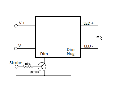

The next step is to connect this circuit to the Luxeon Star high powered LED driver. With circuits of different voltages current and power I like to isolate them with diodes and optic isolators to prevent power feedback that can damage the lower power circuit, so I added three Isolating diodes and two optocouplers.
The Luxeon Star LED driver to use with this circuit is the six wires dimmable driver for strobe function you connect a 2N3904 transistor collector to Dim wire and emitter to dim ground wire and base to in coming signal.
For this function I replaced the 2N3904 with an optocoupler capable of carrying the same current, now the signals are carried by light and there is little chance of feedback or power surges damaging the signal circuit from the Luxeon Star LED driver.

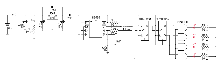

Step 8: Stepping Things Up One
I hate not using all of an IC and just using one JK Flip Flop in an IC with two Flip Flops irks me besides I can make the flasher do something different, I can make it flash Right, Right, Left, Left, and back with the addition of And gates.
To the parts list add a 100k ohm pot, a K845P optocoupler, and SN74LS08 And gate, both And gate and optocoupler can be purchased at Mouser.
http://ca.mouser.com/search/Default.aspx
Send the 555 timer clock pulse to the first JK Flip Flop and one side of all four of the two input And gates. From the first JK Flip Flop connect the Q to the second Flip Flops clock. From the second Flip Flop connect Q to two of the And gates second input and the Q to the other two And gates second input. Connect the set of the JK Flip Flops to the 5 volt power now when you connect the LEDs up to the And gates the same way as in the Left Right Flasher, they flash Right, Right, Left, Left, and back.
