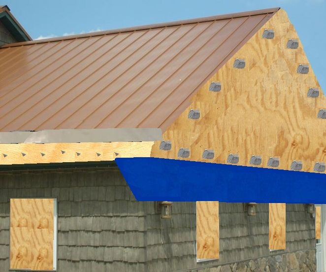

Step 2: Cover Up/ Reinforce Gables and Their Overhangs
If your gables have an overhang that can catch the wind, cover it up so that wind will not catch it like a sail. Wind hits the gables at a 90 degree angle, so they see a lot of force. It will be necessary to put strips of 2x4 or 2x6 or behind these at the points where pieces of plywood must be nailed. Fasten with lots of screws (including some 1/4" lag bolts) for easy removal after the storm. This smooths out your gable from the wind. Important: leave around 9 inches of vertical overhang on top of the end of your roof, where the gutters would be if you have them.

The other thing that can be done to reduce roof liftoff is to place a heavy housewrap style material over the overhangs around the entire building and staple it securely so that when wind travels up to the overhang, it is guided away from the inside corner of the overhang.
The photo above shows such a building wrap, partially installed. Material used could be whatever is at hand; housewrap folded over twice, a pool liner, etc. The picture above shows how plastic (i.e. 20mil or 3 sheets of 6 mil glued together) can be stapled and drawn taut in order to allow air to flow more easily past your house in extreme winds. If a stapler is not able to penetrate the siding it may be better to nail strapping or plywood strips to the bottom or top edge of the wrap material. Try to maintain a slope greater than 45% to reduce the lift on the house.
