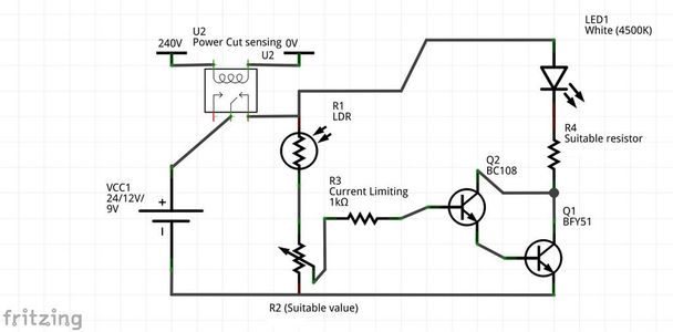

Step 2: The Theory and Circuit Diagram
(R2 and the LDR are the wrong way round in the diagram)
ALL VALUES WILL NEED CALCULATING DEPEND ON YOUR CHOICE OF COMPONENTS
The relay coil is connected to the mains power so that it will switch when the power is on, the rest of the circuit is then connected so that it gets power through the normally closed switch. (see diagram)
The light sensing is achieved by using a potential divider from the LDR and Potentiometer, the potentiometer allows for the brightness that trigger the circuit to be adjusted, this Potentiometer will need to be selected based on the LDR resistances.
There is then a current limiting resistor from the potential divider to the Darlington driver.
The BC108 has a high gain but only low current where as a BFY51 has a high current and low gain, so I used these to make a Darlington driver that can be used to switch on a light or control a second relay if more power is required (e.g. if the light requires more than the transistor can handle).
This system can be adapted according to needs, for instance the mains relay could be removed and then it would create an automatic light that will switch on at night. Or if the light level sensing isn't important then the relay could just be used to switch the light on/off.

Step 5: Make the Light Sensor
Make up the Circuit, this can be done on a breadboard to begin with as this makes changing resistor values much easier.
Once the circuit is working correctly then it should be transferred to a PCB or Strip board.
Use wires suitable for the amount of power you are going to draw.
I used relatively thin wires because I am only going to use small LED lights not traditional builds. The Red LED is only an indicator system to show the state of the system. I have since added the 8-48v LED in parallel, which is the main source of light.
If a larger power supply is needed then a relay should be added in place of the LED and a diode to prevent EMF.(see second diagram)
