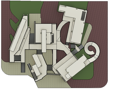

With the completion of the building designs, the focus shifted to organizing them to ensure maximum efficiency. The primary concern was the potential impact of wind on the structures, encompassing considerations of uplift and the effects on occupants within the buildings. It was imperative to minimize the formation of wind tunnels within the complex. The following infographic illustrates the theoretical airflow patterns around and throughout the complex, highlighting the strategic approach taken to address wind-related considerations
An additional critical consideration in the placement of the individual units was analyzing how each facility would interact with one another. The underlying concept of the complex mirroring a cohesive village community remained integral to the overall design ethos. The following graphic delineates the intricate interplay and synergistic functionality among the diverse components of the complex, vividly portraying how this village-like model not only fosters operational cohesion but enhances the overall utility and resilience of the entire complex.

After finalizing the conceptual sketches, the software platform was transitioned to Revit, which became the new host for Vista Fuerte. With guidance from my mentor, I initially acquired a fundamental understanding of Revit. Subsequently, as the creation of Vista Fuerte progressed, my proficiency within the software expanded exponentially through self-improvement, deepening my investigation into the software, and seeking assistance from external sources.
My approach initially involved the creation of elements that were replicated across the buildings. This strategy aimed to ascertain the project's constructability without the need for any specialized or complex techniques, ensuring global accessibility. The foremost element entailed the columns, serving the dual function of supporting the concrete slabs atop which the containers would be placed, as well as securing the containers in the event of heavy winds. Consistent with the project's compositional elements, each instance of the columns does not remain identical. The columns extend to varying heights based on the elevation of the host building.
The subsequent undertaking involved the construction of walls that were distinct from the walls of the shipping containers. These walls primarily functioned as wind load diverters for the complex. Concrete was chosen as the material for constructing these walls due to its high global accessibility as well as its strength.
The second part of the approach was the 1-foot thick concrete slab. Rather than having one single slab cover the whole thing, it was divided by each building's footprint and the walkways that would connect them. Similar to the previous element, the slab does not remain the same throughout. For the pantry/storage and the Command and Control building the floor is set at a different height this was principally designed to protect the items that would be within these buildings. Additionally, it was to increase the aesthetic appeal and increase the imitation of a village.
Subsequently, the next task involved the creation of the primary staircases throughout the complex. This exemplified one of many instances where Revit became the better option for the project over SolidWorks, primarily due to Revit's capacity to incorporate pre-designed features without necessitating manual input of heights, distances, or further details regarding the stairs. Additionally, Revit afforded me the flexibility to customize the appearance of the stairs, notably exemplified by the handrails accompanying the stairs.
The most substantial aspect of the project, present since its inception in the initial sketch, entailed the incorporation of the shipping containers. Rather than sourcing a pre-existing Revit family for a shipping container, I opted to manually construct the container walls, given the requirement for some buildings to accommodate multiple containers positioned adjacent to each other, often with specific walls featuring cutouts. This decision entailed certain trade-offs, including time constraints and various challenges. Due to the limited time available in the drafting lab at my school, the containers could not be detailed to the same extent as a typical container. This posed a significant challenge that demanded an extensive investigation to ascertain the most suitable method for replicating the appearance of shipping container walls. Ultimately, I discovered that creating a profile and subsequently applying it to preset walls proved to be the most effective approach for the model. This method necessitated commencing with the creation of the walls, introducing a new challenge in the form of crafting the concrete slabs intended to serve as both a roof and a divider between containers. Once all the walls and concrete slabs were in place, I proceeded to incorporate the profile into the walls. This involved individually creating a single instance of the profile for each wall before generating an array of the profile, a process repeated for all the shipping container walls.
Between all of the previous steps, I began tinkering with Level 0 of the complex. This phase encompassed the meticulous planning and implementation of roadways, pedestrian walkways, and green spaces. Initially, the project had operated under the presumption that a majority of employees would reside offsite, thereby influencing the initial progression of the project. However, as the project broadened its scope and capabilities, the imperative need for parking accommodations was an idea that was initially disregarded. But in the end a modest three specially designated parking spaces for employees who would be living on site. The reason why it would only be three would be due to the original assumption of most employees living offsite with only a select few necessitating onsite residencies for continuous operations within the complex. Parking for both employees and emergency vehicles can be seen in the following graphic.
Two ramps were strategically positioned to enhance the accessibility of the complex. The first ramp was placed on the road-accessible side of the medical building to facilitate the connection between the ground floor and the typical floor level. The second ramp was designed to link the typical floor level with the command building floor. Both of these initiatives posed some of the most challenging components of the entire complex. Extensive exploration of diverse methodologies for integrating these elements into the complex, coupled with numerous trial and error endeavors, ultimately culminated in a viable solution. The creation of a floor element to align with the intended path of the ramp proved pivotal. Subsequently, the "Modify Sub Elements" tool was employed to manipulate specific points along the designated path of the floor to achieve varying heights. Despite the relative simplicity encountered in the process of implementing the linear path of the second ramp, significant challenges were encountered in the case of the ramp connecting the ground floor to the medical building due to the substantial elevation differential between the two. This was further compounded by the imperative for a low slope, which necessitated a wider footprint for the ramp. The limited space available for the ramp added another layer of complexity to the design. The final resolution involved the creation of a spiral ramp, which not only facilitated the attainment of a sufficiently low slope but also occupied a smaller overall footprint.
