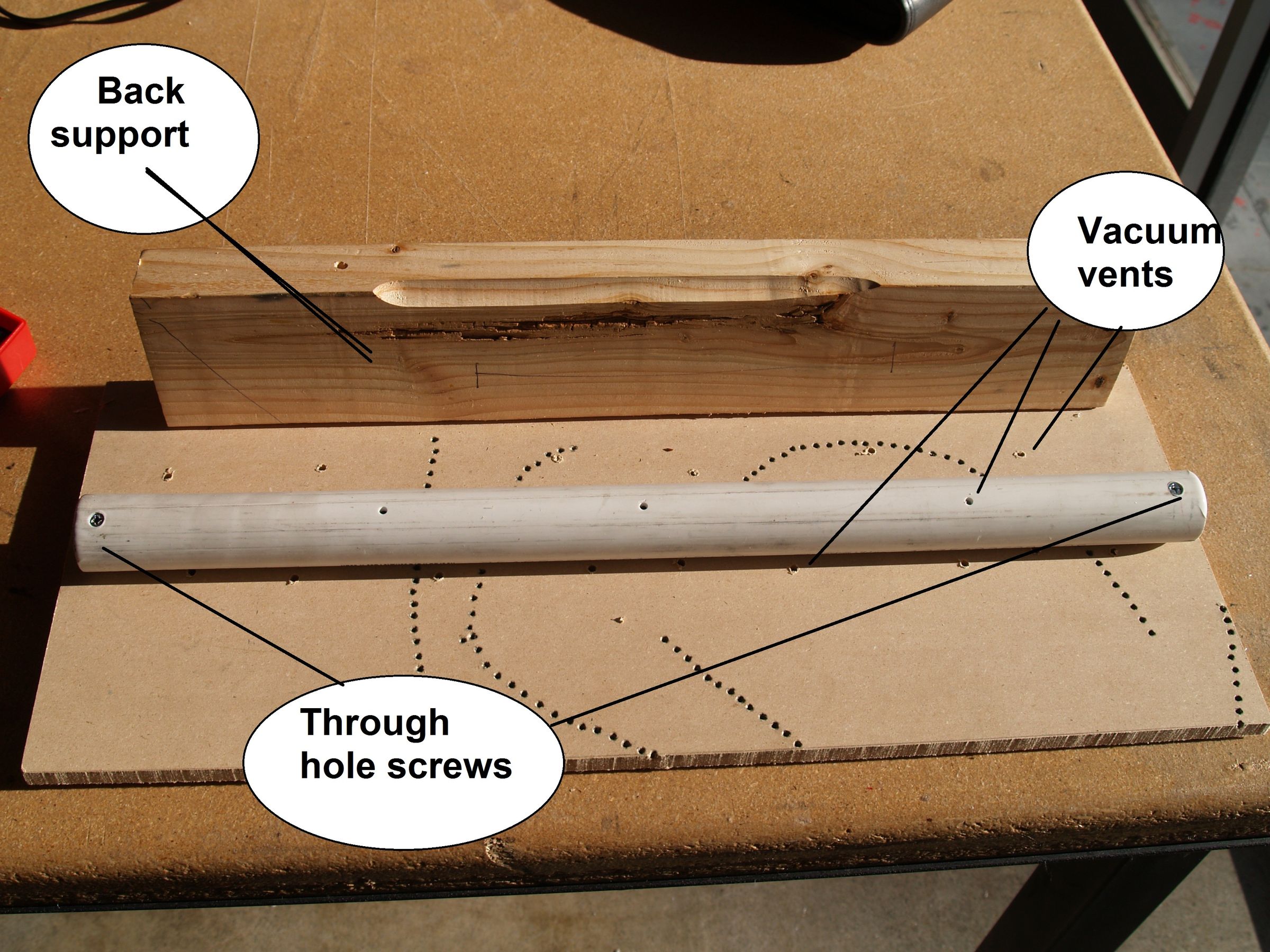

The PVC pipe cut open … I used a table router then filed and sanded around the corners. (If you go that way use the holder from Instructables)
