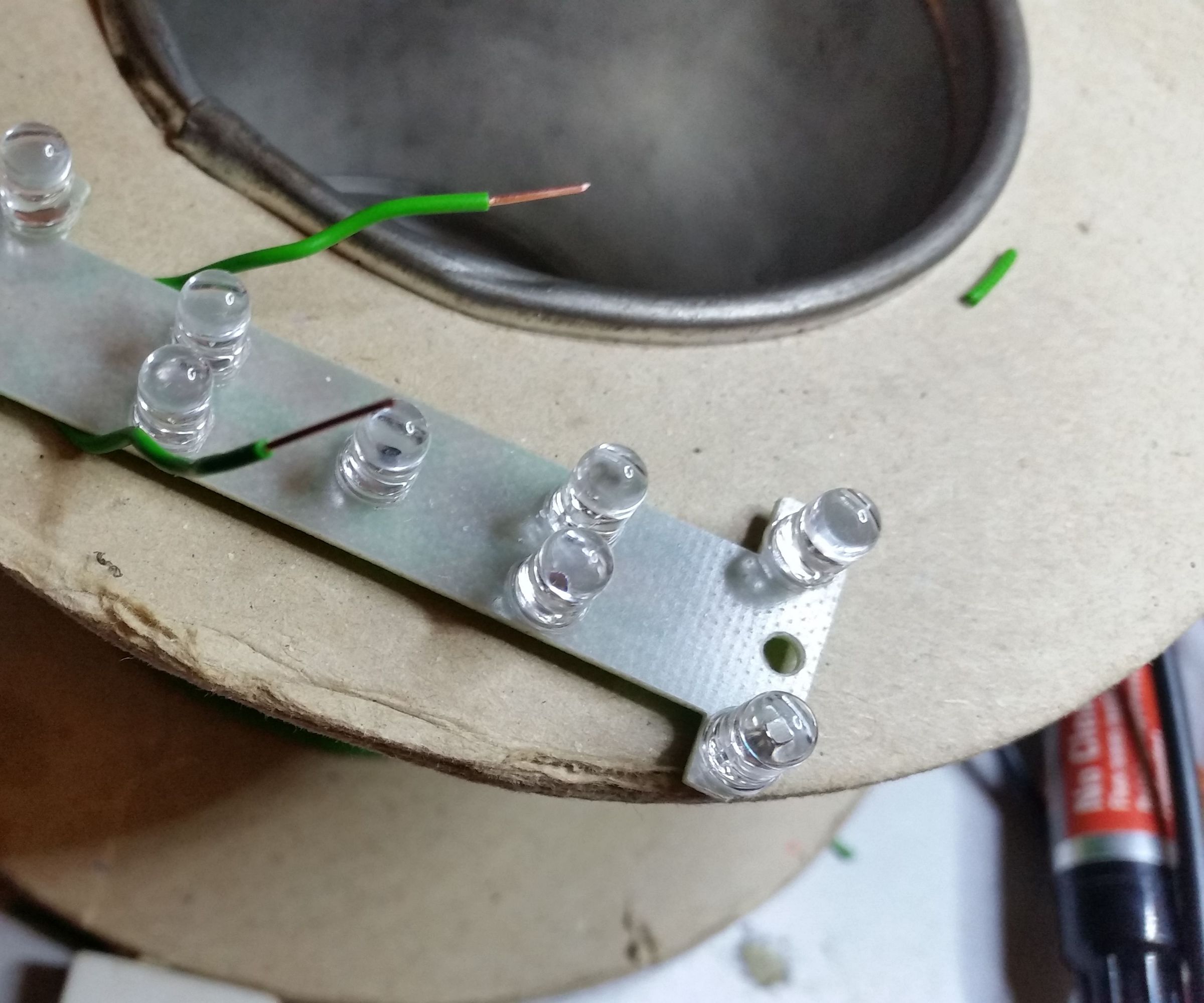

what you'l need:
- pliers preferebly needle tip
- a piece thin copper wire (solid network wire will do)
- a lighter
like so manny of us sometimes we are in a situation where we need to repair something but don't have our tools with us or the soldering iron just broke and you realy need or want to solder something this is what you can do.
