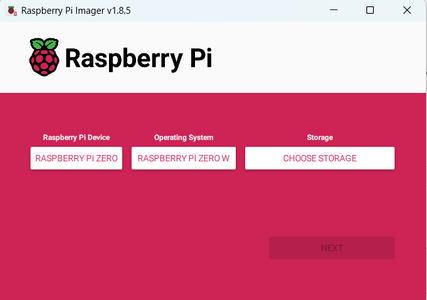

Step 1: Flash the Raspberry Pi
Take a micro SD card and insert it into your computer. Download the raspberry pi imager from here. Choose Raspberry Pi 4 from the choose device menu. From the choose OS menu select the Raspberry Pi OS 64 bit option. Select your SD card from the menu and press next. Click edit settings and input your wifi network and password and make sure SSH is enabled. Take note of the hostname and change it is you like. Finally, click yes and then yes. Once it's done, put the SD card into the Raspberry Pi.
