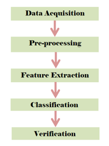

Emotion recognition using deep learning involves training a neural network to identify emotions in human faces based on visual cues such as facial expressions, body posture, and tone of voice. The network is trained on large datasets of images and videos that are labeled with the corresponding emotions, such as happiness, sadness, anger, and so on. The model learns to recognize patterns in the data that correspond to different emotions, and then can use this knowledge to predict the emotions in new, unseen data.
The process typically involves using convolutional neural networks (CNNs) or recurrent neural networks (RNNs) to extract features from the input data and make predictions based on those features. These networks are optimized using gradient-based optimization algorithms, and their performance is evaluated using metrics such as accuracy, precision, and recall.
Overall, deep learning has shown promising results for emotion recognition, with some state-of-the-art models achieving high accuracy levels on benchmark datasets. However, the field is still an active area of research, and there are still challenges to be addressed, such as handling variations in the data due to differences in lighting, facial expressions, and other factors.
Emotion recognition can be implemented on Raspberry Pi using machine learning techniques such as deep learning. The process involves training a neural network on a dataset of facial expressions and mapping them to specific emotions. The Raspberry Pi can then run the trained model on incoming video data from a camera to detect emotions in real-time. However, implementing emotion recognition on a Raspberry Pi can be computationally intensive, so it is important to optimize the model for efficient inference on the Pi's hardware.
