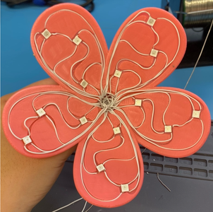

Flower LED Strands
Materials:
  1. 30 AWG stranded white wire
  2. Soldering Iron + Solder
  3. 140 NeoPixel RGB 5050 LED with Integrated Driver Chip – SKC6812RV
Wiring Instructions
  1. Use the small stationary flower and the petal of the large moving flower PLA or resin printed rendering to measure wire length between each LED along the tracts.
  2. For each data IN/OUT tract cut the 30 AWG to the exact length
  3. For each 5V+ and GND tract cut the 30 AWH to ~12-inch strands so that they can be thread through the hole at the base.
  4. Strip 1-mm from each 30 AWG wire strand
  5. Tin the 30 AWG wire strands and LED solder pads
  6. Solder wires to the appropriate solder pad of each LED
  7. Use this datasheet to determine the pinout of LEDs: SKC6812RV Datasheet
  8. Repeat for all small stationary flower and large moving flower petals
  9. Splice the 5V+ wires of each flower together
  10. Repeat for GND wires
  11. Repeat for DIN wire for small stationary flowers ONLY
  12. Verify data IN/OUT connections with wiring diagram
  13. Thread the LED strands into the flowers and along the tracts of the petals
  14. Screw tinned wires into screw terminal connectors

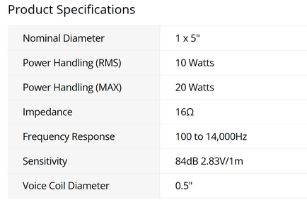

Step 8: Audio System
This audio system utilizes TV speaker modules in order to output quality sound and has its own installation needs to prevent the sound from bouncing in weird directions.
Necessary Supplies and Tools:
  1. Phillips LCD TV Full-Range Speaker Modules (buy 2x)
  2. 2 x 30W High-Power Amplifier Board
  3. RHINO Power Supply
  4. Power cable
  5. 3.5mm aux audio cable
  6. 1/2in-13 coarse nylon lock nuts
  7. 1/2 in x 1ft stainless steel threaded rod
  8. Table vise grip
  9. 3/4 ratcheting wrench
Electronic:
  1. Elongate power and ground wires on the speaker by soldering and shrink wrapping and extra 3ft cable to them
  2. If using stereo audio be sure to tape out which speaker is left and which is right
  3. Add power and ground wires from both speakers to the amplifier according to the silk screen printed on the part
  4. Create and connect power and ground wires that connect power and ground between the RHINO power supply and the amplifier
  5. Plug in 3.5mm audio cable to the respective jacks on the Raspberry Pi and amplifier
  6. Make sure to turn the volume knob to desired volume when playing audio
Shelf Installation (see Step 12 for order overall installation):
  1. Determine when the speakers should fit on the shelf to fit in the hole in the table
  2. Mark out where the holes for mounting on the speaker are respective to the shelf
  3. Drill those two holes slightly larger than 1/2" in diameter
  4. Cut the 1/2 in x 1ft stainless steel threaded rod in half
  5. Thread a nylon lock nut on both rods almost all the way to the end by placing it in the table vise grip and ratcheting it down
  6. Make sure to leave enough room so that the smaller end of a rod can fit another lock nut as well as be threaded through the shelf
  7. Put the threaded rods through the holes and ratchet two lock nuts on the end to secure the rod in the shelf
  8. Lace the speakers onto the long end of the rods so that they fit where they should in the shelf
  9. Resecure the shelf to the table
