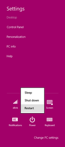

Step 1:
Locate the Restart widget.
Before you press "Restart", keep your finger on the shift key. While your finger is on the shift key, press restart. After that, let go of the shift key. It may take a while, but you will then see a blue screen. This is the Advanced Startup screen.
