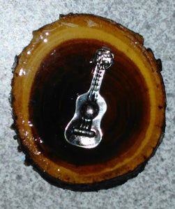

Now if you just want a gloss in the grooves you are good to go. But you can dust clear on top of the surface and heat this give you that all over gloss look. Layers can be done to achieve a thicker clear look.
The round slice is just clear with a metal guitar charm.
