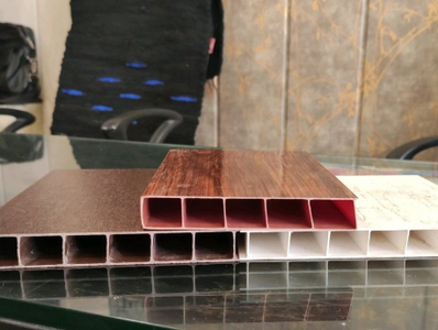

This table top is constructed using repurposed hollow uPVC plates from a previous project. uPVC (unplasticized polyvinyl chloride) is an excellent choice due to its durability, resistance to moisture, and fire-retardant properties. Unlike wood, it does not warp over time, is lightweight, easy to make with and is easy to clean. Additionally, aluminum framing is used to make the enclosure, making it lightweight yet strong.

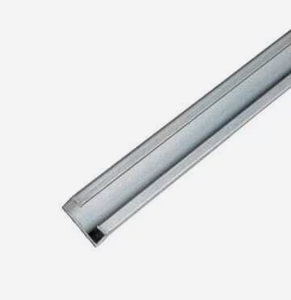

Aluminum section: Channel (20mm channel height, 12 mm width). A square section or angle section will work too.

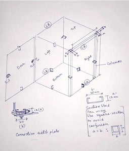

Step 1: Deciding the Size of the Enclosure
The first step is to determine the right enclosure size to fit the 3D printer. My printer's maximum dimensions are 730mm (height) × 480mm (width) × 560mm (length).
To ensure a comfortable fit, I selected an enclosure size of 770mm × 520mm × 600mm. This provided adequate clearance for movement, ventilation, and any additional components. If your printer has different dimensions, adjust the enclosure size accordingly.

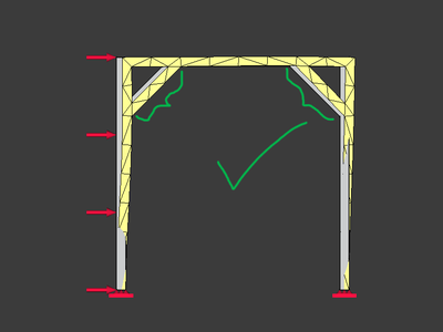

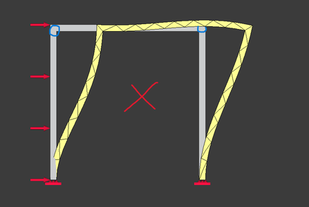

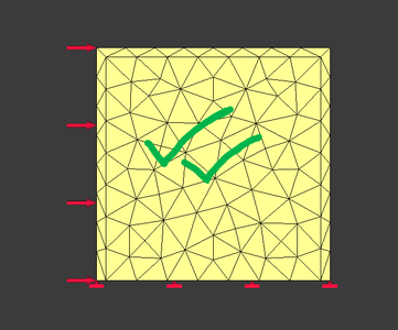

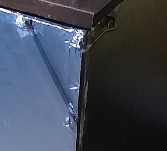

A stable structure is essential to prevent unwanted vibrations or movements during printing. The basic frame must be designed to support its own weight and resist external forces. Also a rigid frame will ensure there is no gap between the door and the frame.
In the corners, the beams are the weakest if not connected or welded. So its best to provide bracings or connect them to plates as shown below. The plates act as stiffeners. Hence it is very stable. But for the door portion, it may bend without any stiffener. In the initial tests, the door frame lacked stability. However, adding corner bracings significantly improved rigidity. You can see the comparison in the attached images.
For additional verification, Finite Element Method (FEM) analysis can be used to assess your structural performance under load. If you are not planning to make a super heavy shelf atop your enclosure, you can omit this F.E.M step and design similar to what is shown below. It is very strong and can handle loads upto 20kg or above .
Step 3: Choosing Structural Members
Once the enclosure geometry is finalized, the next step is selecting the right materials:
  1. Enclosure skin: Use aluminum plates (recommended thickness: 0.3mm) for durability and fire resistance. Don't use any fire catching material like Plastic/ MDF/ or similar for the main body.
  2. Frame members: Opt for profiles with flat sides to ensure better contact and easier assembly.
  3. Strongest/ costliest: (Square/rectangular profile)
  4. Mid-range strength: (Channel profile)
  5. Most affordable option: (Angle profile)

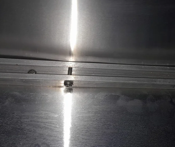

Step 5: Bolts, Nuts, and Fastening
To assemble the enclosure:
  1. Drill holes in the aluminum plates and frame members at proper intervals.
  2. Use screws and nuts to securely fasten all parts together.
  3. Maintain a 150-200mm hole-to-hole distance for even load distribution.
This method ensures a rigid and long-lasting enclosure capable of supporting the 3D printer while functioning as a workstation.

Cut the extruding part of any screw end with the griding machine. Shown in 'Screw cutting.mp4'.
Seal all edges with sealing aluminum tape to enhance durability and airflow control.

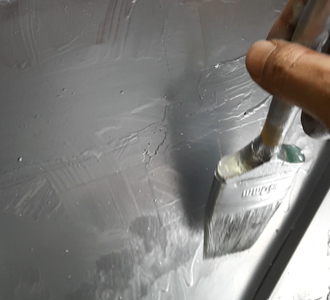

Then Paint the box with aluminum paint. Let the paint dry for at least 8 hours.

For the rack, use lightweight yet durable materials. Plywood can be too heavy, making the structure bulky. Instead, uPVC sheets are ideal—they offer high strength, are lightweight, moisture-resistant, and easy to clean, making them perfect for this application.
Cut the uPVC sheet to size for the tabletop.
Prepare four small uPVC pieces and glue them at the corners—this will slightly raise the tabletop, ensuring the door moves freely without obstruction.
Position the four corner pieces directly on top of the vertical columns, not on the beams, for better stability.
