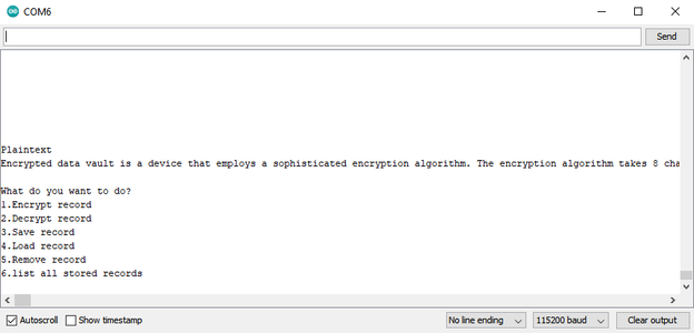

Step 8: Encrypt Record
Let's get to the part where this device finally does something useful.
This device encrypts passwords, notes, phone numbers, and whatever you feed to it.
I was able to encrypt and then decrypt a 704-long plaintext (5632-long ciphertext) without any problems.
To encrypt a record:
1) Open the Serial Monitor;
2) Set the baud rate to 115200;
3) Reboot the board;
4) Enter 1 into the text field, and press send;
5) Enter the plaintext into the text field, and press send;
6) Copy the Ciphertext from the text box.
Eventually, I came up with these results:
Plaintext:
Encrypted data vault is a device that employs a sophisticated encryption algorithm. The encryption algorithm takes 8 characters (64 bits) as an input (if the input length isn't multiple of eight ASCII characters, padding is applied), generates 64 random bits (8 characters), and passes 128 bits to the AES (Advanced Encryption Standard) cipher. After that, the AES's ciphertext split into two half, 64 bits each. Each half of the AES's ciphertext then passed to the Serpent cipher alongside 64 random bits. Finally, the resulting ciphertext is the concatenation of two ciphertexts from the Serpent cipher. Random bits generated during the encryption process are disregarded during the decryption process.
Serpent's key:
761087A94F7C7FBC955AC330F61A4797A2FE095D6114C7168F7C75954C5281BE
AES's key:
e=Alvy+-$kI>#57?
Ciphertext:
DD125210C719510EA62B92BB9774E66F269EB9C4F3BD14365AB23C456B7C9DB43E04428A02312600D9C2B72FC0E5BD1DAC2A26619561E4409E05631BF3361F944BEB5948C931AD0EB1D846853894FB378A682571F827BC578A967DDE934340999129A8D24D608734D5C6724FB911EA622A7043944FEDC1013D27110A738A84D2FF05AF884811DEB8359E8F6F05EE9100D531BDDEFB78FDF417C0A2078E24A8EFABA5980D22F2B134FA5D687E6879EE81C8A8A50606E4F75D34971259EC26B8359A42B0F29382499DC164356D16D99FC02ADDEA003B1DF05D66906B8B724BC9D410289B491AB23F1BF3056C782E2AC0FE8CD2AC7209BFED6BD975001341EF58D90D3AE224A71287725787CB52214C3B66E1C8997E2E1FFE46B5648F12F3C030D2BF4B5A700E2F0040812CFD1AD5C19487991CF84CC2E77376CE200183BFB496718828D72CD329D4CEE256ADB639BDAD3F4B478F7C1EC8566281531687FF3B20407A91C45A2E0DAEEC43CF67B2C671DB9E0214813A9F99B7C0042008EC0B691774982ED78D5C843AE244653BEFE8DC81FBD957D2559A325F42DC5D316C95F9C1B8C0B3FE10A9E59009DD41859F4AF7A2A3E595FD317AAE0B17C5E4DD200737E447EA9CF32C4F6243CD8DC8C60BDF68D6A58F2B210B0DF282901661CDDBA84EC7B0F3E1E0373D4EED272A4E73562875272C51E550D82E4A14AAC099A3DA89AF0F4A0DB1EF1A5B7818CC55274C89F059037436B467926D618A2E1D276191A95F2F2F53EC5B29C95E22A56C96A8052ACD0EBD63F8818BCA67B90E58B4F73CEA7A6D9C6F44C8E9416FEA04304602A42B14E87F423B512F5EE419153E6C805D44E97492117772A4BEBD83F1AE7C35D1F392356B9442075A62FBDC41618DF8A24B3CFD4C6353CD567C8FC5EB5182D9EA9DFD0DC006F1C52B307C855D8D8D9F625873B25DCCE82A8C4108D4A94783A99DC03BAAA0E6BE1D9BA553C19DE6C408B38E3C1D505F0123E5F6A4A504926FD5F59640E38848FF8154BA3376E322FBE51A3FB5886316AD45B13D20DD29098352A542CA13781A0AA0715DC221378C96B84CDD1AD8C557C89968895A85E6C38C5CA12DF733DC07178ADF49ADE71A8D9E1055D24513CE6F088463E2D13A17C9FF29C105241F23B52789CB6811B310D43684FDA84F1010D7DBBCF7CA159CF923C94C30D586BDD43EF998CBAB0CF85EF50CCC1371FB0D0E8075B044BE39AB8A880A0795E1730563A676A1350C22918B449279F2D9AE453421E80F684325E2BE4D79194C204D1E9DCE41456AFD48E47961506AD27A15D214D68C82E377A55287529C3AAB6F4492203D24ACED1DDA0D163BDB64F90548BD529CCF1E88607F3CA9C9525C7FFE3D997C2591725E5072EF5F418A0361BFE83FBF0C0767DFF43407025285CEE507DD6B164D39F15F332DCC680FC7D2F480D81312B17B1E7C1CA609E1A47D64036D8D906F41D2781E901DB4EDAF4CC9C1AE075C58086A351D96F3F105EA4E5A9A3FA9E1F6582E6746C9054EC427C72B20FA735F053C08F1207290DC9AC8F89ABC56A89FCB5F939AF3E0124BE7B2A6A44943D381F81575DA76989D3F31535F82678B9FE87568116A67755E51B990FA78C062F9637DB179E383E45BB3F946847C663248FCB46F47C010917587B1E2600FC3DC80507E1AFF28A1B2750603C9E3B5E3CFB9ABE6E792DDCBF4FF9E5A8FB324ECD0C83372AFDF59C69B198190A131854F291820A745CC67427EACD25A13B1A7986300C2948B351987FF5A2C670EC9BBC603497863EB6140C30FE05AC9B45EFE82AA2FE054B60466A08A5FE3DCAE0414DA70667AA4998B850EB4220C03F5D80A7E6791A0CC2DCCE54E72451FEDFC7CC5DD1A62B48266B965C0568427C403386D9082006370C38BEC33C64530268FEE06270FE3EDAF1EB6B93F5096DE39F87E3B3D684AA75536455DA5292466E03FB475E317849707801A153B7033D18FA65CBD9D2B0CC9DA6B38CD69F4B2CE884199F730103D4E26CDD3442526F81EE0919B65ABB6994805A4172BDB28E840C7D7A929360CFCFFEC13E9197B1907250E73F789A52C418E101C82409FA20C3324DDD7B871D3BF3C1F316F44A6BAA62A7162290AC173BDA8E11F6B6F45B5427B58B8089B93961712E25991C18CBF47F580670F99F61D8C45714790BB87FB280CBA1EC8C92C1BFEFFC536DE4159029ED2333AEF970E7DA348FFC0BA288303D72DBA105BC366E9C7D1A1847D65B84BB6415C5B8F46FC914C713D689FE1C5737FE85168E1CA9E2ADD27AABB6675EB183665527EAE6F2F16E3EC8F2D110B8312793131857D8D558F3D120629C872BB2C813FB58B01BB1175D870E30EE85AF233EC687B6072385125445F4EC7206DE7BFEAC4D01087196DD00EB2D0977F894933C95C78028CEA688A8FE9725E1318BC9DE922F497C84B0F48F7C0B655D80E0FFD2216532B3AC37C6D90980640A668E59D1683A278D3C2CB69C1EBC598C06DBA23E27FEB29BBD7F224A4CD3426728B02F4794A33DB4B79F65D8C501CA9D8F15A4DF0981B62C6AE2051E6A1E65454E5C81CA168495E4B6C378074FD4320B62319206CAF70BC85904624AB4FFF4D57816F6F94F3F3EB43626FD2C4E3A3BA95E1DB78B45FF0427720692A7394C1CBB85F1E3169CA2F2E1C5C0CAF78EECAADFD3AFF2263622372DBD9B1DD7F7BE9003028B7853BF5049D4C42712E2A97DA03E7FF509AEEFE84B0887CC0BD21FCCCEB85BE45153715720158FDCBFD56E05A23DB68B5B0F693457E42637154B686F50F33F272D5793DDF143DD041B24C5FD9AE4C0BA8217296532C0CA1D2307AFC7CC1007E434E1812DE7E66F6209F60335DECD5E07A0F46E879D6C6C5AE8D49DB0792505CBC84B31A3EBA9812D1F01E11CEBC2F762B65A172AB014E3F5079FDB9AD945A581AD9AE1EC24CEC757C05B5FF2307A096C9CF844DCD74CD61984EDC8E5ADF40F10CFCE7548F7390C2AFDE8076DF0515B59D5BEF1EDC31D60CA15DDE0B1ADA5E1E613D9D33964BA8E1A68E3B24D17D85C90C35243555DF3EF788EA587E7BDE768EE9BC21AFC2202E1FBF750F0F55C83CB2C5CFA52092BABF759CC58BB522C71D525BC14E187CCE4625220186D82B0BCCBD5DC9E941DBAC3A9EA8F6BF3722ABBFEEF1D671A2A7F097AA25A19AF44A111570539F66CC0AC3DE527A2778A7E9744CF29915D5F830E2B4671E2B23263E123DDB4A30FC2E5A571F783977754F953FC38F08B3F28DD06125A09592B228670167FBD78FB7C5494A4C7845AAC92B073895643CC9548D9EF05A74057871F36E7984E74FBBBBD9ACC9BA903733523480813016363E5C8054E6168340F6D47948A58D4B2F22266FFD68AF1B6F278C61997FEB3A152A80921702D49A08895E1E4D362F51747961BB0D262E813261EC37554818F9878BECC96B053DC351A2592CB30E625661C375585D54F6E750FD96FCB4C9BB920EAE194B0934A57C92BA8E8D4C2EFC1E023842C727F0814809652EA2FEE84C2F7E87640DDDCB03E92DE29AE64F0D5F979C6CE75143433C165A2861936852EF75429B400E1883BA76FD835740327559B73C88B4F58E6353DC4F8DC48414A6B16537D7919B9985A2C772E1D0CDDF3E8C75404C9CB0A6449E2266E1FFA17AAEF6A8B169FC7DB011E77ADF9A6DA9A61E1A05282045EEAC70F65F8AC600E8747A786AD0C7F8901057571AF1AF2A629CCE40CDA702E600B3D826D5A03663E522E68EE5CA1D3AE7DDFCFDD7152BBBB837880804173118AECF4A5BD96761BFE578D5B404CDBD93A17F819F22BC615978BA3408C6438856A66089FAECB4626F5DB2B0C89C0D3C50858CF16864F309BDA63DD3F2BD3F78B1533C458A456BDFEC1387AA4AA2DA3806B922D3E242C5C3CEAEF85B907615F8951B6F67B1F47B9B48E4B4B540167173E9A9D584470DE68ED555861EFB540C2CCBD585CB5C1C2496E3F28CE1344A0DA9EB53C04B3ECC4CCA20E40C

Step 10: Install ESP32 Filesystem Uploader
The primary purpose of the ESP32 Filesystem Uploader is to let you upload files into ESP's filesystem. In this tutorial, the purpose of this tool is to upload an empty SPIFFS image into ESP.
Download the file called ESP32FS-1.0.zip from here: https://github.com/me-no-dev/arduino-esp32fs-plugin/releases/
then extract the content of the archive into the folder: ...\Arduino\Tools\
After that, restart the Arduino IDE.
Step 11: Upload an Empty SPIFFS Image Into ESP
Click Tools -> ESP32 Sketch Data Upload. Then click Yes in the pop-up window. It's going to upload an empty SPIFFS image into the ESP. I have no rational explanation for that, but after that step, the file system finally begins to work as it's intended to.

Step 15: List All Stored Records
I've created these three files to show you how it works.
old password
new password
whatever it can be
Filenames displayed with the slash / before them. That means that the file is stored in the root directory. When you enter the filename, you don't need to enter a slash indicating the root directory.
To list all stored records:
3) Enter 6 into the text field, and press send;
