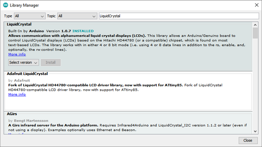

Step 2: Install LiquidCrystal Library
You only need to install one library for this project (if you haven't already installed it before).
To install LiquidCrystal library click Sketch -> Include Library -> Manage Libraries...
Enter LiquidCrystal in the text field, wait till the results of the search appear in the form, and then click Install on the box with the LiquidCrystal name.
Every other required library is already installed in one way or another.

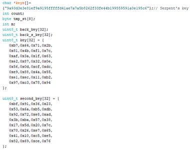

Step 4: Generate Keys
You can do it by any means possible.
The best way to do it is to throw 20-sided dice.
If you get a number from 1 to 9, write it down. If you get a number from 10 to 15, write down a letter corresponding to that number.
10 = A;
11 = B;
12 = C;
13 = D;
14 = E;
15 = F.
If you get 20, write down 0.
If you get something else, throw the dice again.
Since I'm going to expose the keys to the whole world, I've used an untested RNG to generate the keys, don't ever do that! That will compromise the security of the device.
Step 5: Modify Firmware
Open the file Raspberry_Pi_Pico_plus_ESP32\Firmware_for_Raspberry_Pi_Pico\Firmware_for_Raspberry_Pi_Pico.ino and replace the existing keys with those you've generated.
Note that all keys are in hexadecimal format!

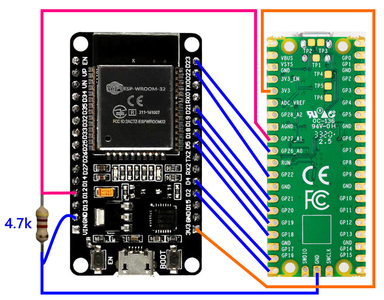

Step 8: Connect ESP32 to Raspberry Pi Pico
You might be wondering what's the purpose of the ESP32 here. Well, It's simple and kinda questionable at the same time. I wanted to use Raspberry Pi Pico's built-in random number generator. Unfortunately, it turned out to be insecure and not random at all. It seems like there is a predefined sequence that the generator presents as random. To resolve this issue I've used ESP32 as a random number generator. There are no advantages of using an external RNG, besides the fact that it at least seems to produce a random output, unlike the built-in one. The interface that I've implemented to connect ESP32 to Raspberry Pi serves its purpose, although it's slow, primitive, and not exactly what I would call a pinnacle of reliability.
The circuit diagram is in the step N9.
Step 9: Circuit Diagram: ESP32 to Raspberry Pi Pico

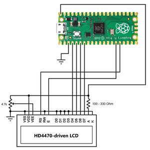

Step 10: Connect 16x2 LCD to Raspberry Pi Pico
I've added a 16x2 LCD to make this device easier to use. The primary purpose of the display is to inform you of the current operation and the progress of this operation.
The circuit diagram is in the step N11.
Step 11: Circuit Diagram: 16x2 LCD to Raspberry Pi Pico
The resistor connected to the anode sets up the brightness, I've connected four 560-ohm resistors in parallel (1/((1/560)*4)) = 140 0hm.
