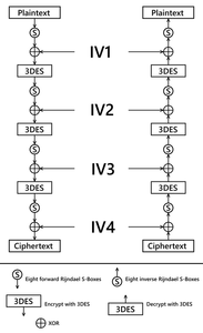

I decided to use M9DES to encrypt/decrypt passwords. Four IVs are randomly generated for every 8 characters of the plaintext.

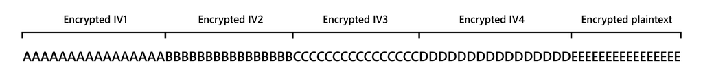

Step 2: Structure of the Block
The first sixty-four characters are the encrypted IVs. The last sixteen characters are the encrypted characters of the plaintext.

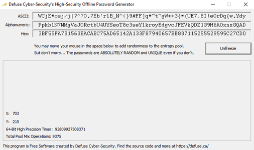

Step 6: Generate the Keys
You can do it by any means possible.
I can only suggest a program to do so https://defuse.ca/passgen.htm

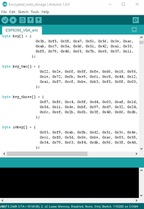

Step 7: Modify the Firmware
Open the file Encrypted_note_storage.ino and replace the existing keys with those you've generated.

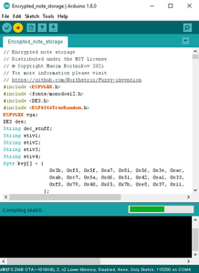

Step 8: Flash the ESP
Upload the modified firmware from the folder Encrypted_note_storage into the ESP8266.

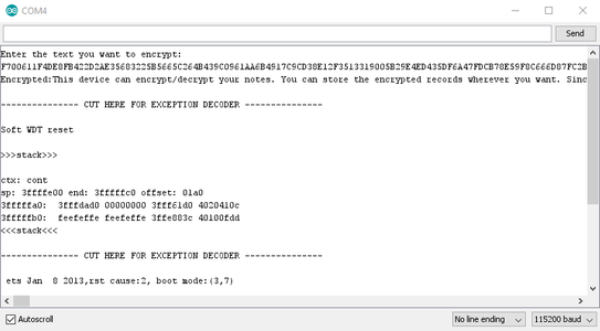

Step 10: Encrypt the Note
To encrypt the note:
1) Connect the USB cable to the ESP;
2) Open the Serial Monitor;
3) Set the baud rate to 115200;
4) Enter 1;
5) Press Send;
6) Enter the note that you want to encrypt;
7) Press Send.
After the note was encrypted, ESP will throw an exception and reboot.
The memory of the microcontroller is limited. Decrypting notes longer than 500 characters doesn't always work. I wasn't able to decrypt a note longer than 561 characters. Take it into account.
I encrypted this plaintext:
This device can encrypt/decrypt your notes. You can store the encrypted records wherever you want. Since keys never leave the device, it's nearly impossible to decipher your stuff without the device. Decrypted notes printed in both the Serial Monitor and the VGA Monitor. In addition to the device, you'll also get a program to store, modify, and organize your encrypted notes.
And obtained this ciphertext:
F700611F4DE8FB422D2AE35683225B5665C264B439C0961AA6B4917C9CD38E12F3513319005B29E4ED435DF6A47FDCB78E59F8C666D87FC2BB3986A7BE6D329EE5356F442DF4A0A0ECB2069D543014016298E33CB0EC964106F4F562300B17B305343BA9FB17B227E17DE48BFBE6C67063D8B0AD4A3C74AC66A118FC50D4A731FD9A0F2F212510C151B604419C2BB7E28C21BEF527F095597FF60DBCD4CB353901C4633C54C70523C5CDF517ABE09A97F1322BD9F884783D339F55E2F596FE72398F1675E1602685BD8675A6AB3881CFBF7743715471DA77E2349D15B2B77D93CF796F0DB38CA83107493789F5127D6BFDEABA59AA534E72FBDF44C6F8783C59C7440428B8863908AF886A0EEF4294EC210AEA293DE6750DA173032DE1952A3633E01267D9DA5FD280DF513F8908723406AA58F6F31A1A8449FF259998A953BC55C02AE27FB0B8619637DF7291E063DF0AEE43DEDDCCCFE6DA6562320FB95637714CC053702052650BF315F1ED95266BA5AA374C361AAD3E28F5962DCF75F8944A15E4890CB5D052CF297777F7849BE57D7470BE63EBEE988A12C8DE2A7E56D8D7FEE99AA8084476EE8B4F77F9CA90DBB7912003FF9145FBB6DA8181C058E12914E15710E7A6ECF6D741983390E96F53D3C1B0ED63D997BEDA167A752A276759BDC9E9E69F337399D3EAEA7120965CEB5E395CF51D0F36EAE59FD5F4E0B44350091D6C2FD49E5A0639BFFCC244A3F73919162194DA4DBE9A0609B8B4E8484E623448DDF0DECE485EFA33308D8384D34269510F7DCDAF66F7BD20B44266B92A04C5F617962B2FC3303034EA151C9C940EBEAD15FA3C6D1AD94108C96C9E820347334EA11E9C79D08D5979AED33363D950661104D1004841E78D59D5C755EBBB2D89026C7BD19BCCB619BA9359252C86665CF639DFF1F22CD02CFBDC449DFCD8F37FCE5AD5DABE3278215095A33DD6ECB0EF5CF17B9299A1799130B280CD57C0F4C8C28DA7DABD784CA4EED85926134A8CA155F36D95DFF9A54656E1ADF70AEACFE526DEC6DEE9042401348F190E5F14C2D1B3CF338E41E10FA187252D655D1B1E7D594AB5A479D4EAEA1E244C6374581DC16D6680886E3055FF971D650F077FDF3667DD60BD1226434770B04241EF00B8FC488935E482BDEC5711F622CE6186A13C1EC3CBCCF8B1DCCC58D5A316194D8FB894FD55F1E5DEA557ACCB8F3FA2B957642E1F250BAF2FEC846E6D07225A729C2FC44B55C84BB1D0CB9A3B6D9E83BA210EAE4BF2891DE36F7E91CD503A30751004A60E208AC88009D6C959D5BC070170A75BE0B52AC04268524DA6CBB728457FA9648BAB922E063BF0BF8CC9A156560EA628118219072BA1B14B42FBD97B6A0B07EA2107C93A9CCD54550D277381829A378D7A41C3F9EA2569420767B6DC91FB72155BE21052432AC5642B50BD5012AF1CC45C0F26B1E35C2907FD250DB3B0CFEEAD8E9833E7DBC21996708372E87029375A9EFA656141B6A7344BFC59FAD17B0257F2859125A46CA747F3381B8387691444E194379928EF211A9528F62F419C89B5E13F7E48A2283D80C6DE3F3C18D1126443F604936836CC88F79CCB926871EEA98CCD15255D859D6C23CB5AFB84989635B88AE8496B16FE09F15449C8589A5986F547C8FB642C2D7D32FB2D386A2F75A39EF4D11B8AE47CBA2BD55718D08F97FD168973C6B16CBCBB29038A000F9D95FFC8604F1AB94C61146B6C7ECDCCC0F3D3C42BC77ADF812D06A9DB3B1FECFC20A4A4AB9C16B48657B412377870DCD1187EC796D4AB3FC4B666DB276403D8573D9B1E9590C937D67F81CB77FB587512EF245C3470AAD6A4A234061CC2AF7955E1705B72F5F679F404C906F8606F530F4CD255B1BC9AD72251EE584FD17D6ECDAE7BE5B392446B81FCD8C533A7077ED3A766DEA2D1D3208C9E6DD6914481B14CD7CC9F181B1043A61CF6C029E49619B152A1B061118CDDCE0C17F947280F5BC7C1C521B1656C1596787830A6B11041A96DFAFB6525482130B467C80BC23CCC65047467FF1994D96877F095D33A237112D465A83BEEF6DB80658337C3084A4316DC0DBDCBF9B1C5A19E1203A1FCB6686A6EB9ADEFD2BBBBF7AF84D892779961CA5C7F6A17B58AD14EA454F318936405F3184061BD6B97056FCADE24D1040B69353C7A7D41405B3C341723885F4C8F5E8BBDC460FC63600BFE426D0D1217372292C9EA74014795FF2C50A37AC16BDEA4BFAAE4D48640F86F6F4BF8F340FC52DA371DAC4840653CFD9B2A0B13FD7334D382FA94371420C80F5D8991FD82F281E5B9316A7BC5BE1C216A45EDB8834C6C59274E14C62F99F649BED60B50F5C1990AE9D1A09BE039BDE7A33D571AA8B04183B7511D5FC5468C6408985262616EA39872879230E4472408B0C886F104B5FFDDCCAB803CB171C675C578A3DBDA9F745A33B4600B81352DA5A006A37E5377965C90166EA1F9E1DE1DE23B8F8FA814748F8E82C11DC47057513D186E9FDCA9B8167665CF2CBDE685CC2D55C5C2D7A4EB7129A0B6FA086B37873A361CFCD66F8F0F24BD73E98A8B3BEFD487304CE3B183641D7207CC8641D50F6F30B2180874F5CAC239B56E69D757A42F519A5D0A5FDB0625CAAB62EB289C8313B9BE2F76A05340DE05F6FA533BA88AB8D42304AA7BDE2EFF367538EF57272D0481DA4DC9FC09FD11FC5B233B9D7DE9AAC3D6B52E6B50378A

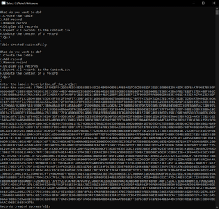

To put the encrypted record in the database:
1) Launch Notes.exe;
2) If you're launching the program for the first time, Enter 1 and then press Enter;
3) Enter 2 and then press Enter;
4) Enter the label. Make sure that there are no spaces in the name of the label;
5) Press Enter;
6) Paste the encrypted note into the program window;
7) Press Enter.
If the plaintext length is longer than 408 characters, store the ciphertext somewhere else because the database will truncate it. Let me explain why. The algorithm only encrypts blocks of 8 characters and produces 80 characters ciphertext. 80/8 = 10. If the plaintext length isn't divisible by 8, then padding is applied. Technically, the output is ten times longer than the input. 408x10 = 4080. The maximum length of the record that can be stored in the database is 4095 characters. Add another character, and you will get one more block. 416x10 = 4160. 4160> 4095. Therefore it must be truncated to 4095 characters.

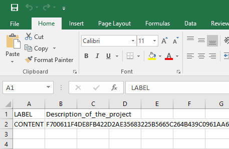

Step 12: Export the Encrypted Data to the .csv File
To export the encrypted records to the .csv file:
1) Launch Notes.exe (if it weren't already launched);
2) Enter 5;
3) Press Enter.
