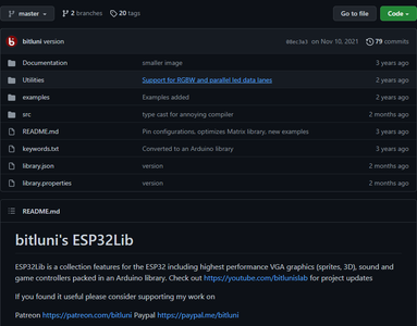

Step 4: Download and Install the Bitluni's ESP32Lib Library
Download library here: https://github.com/bitluni/ESP32Lib
And then unpack the content of the archive into the folder: ...\Arduino\libraries.
Every other required library is already installed in one way or another.

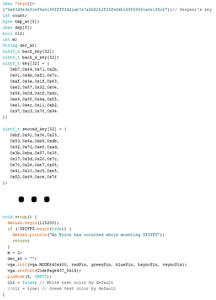

Step 6: Modify the Firmware
Open the file Encrypted_note_vault_version_three.ino and replace the existing keys with those you've generated.
You can also change the default text color in the setup() function.

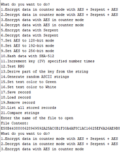

Step 13: Encrypt Note Using AES + Serpent + AES in Counter Mode
To encrypt a note using AES + Serpent + AES In Counter Mode:
1) Enter 1 into the text field;
2) Press Send button;
3) Enter the note that you want to encrypt;
4) Press Send.
I was able to encrypt and decrypt a 512-character long note using this encryption algorithm without any problems!

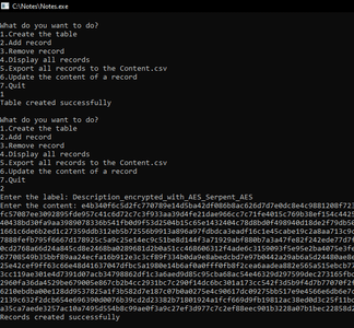

To put the encrypted note in the database:
1) Launch Notes.exe;
2) If you're launching the program for the first time, Enter 1 and then press Enter;
3) Enter 2 and then press Enter;
4) Enter the label. Make sure that there are no spaces in the name of the label;
5) Press Enter;
6) Paste the encrypted note into the program window (Ctrl + V);
7) Press Enter.
I've added all three ciphertexts from the previous steps into the database.

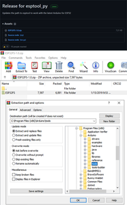

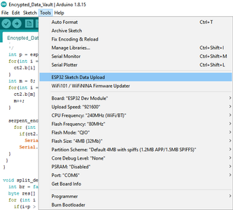

Step 22: Install ESP32 Filesystem Uploader
The primary purpose of the ESP32 Filesystem Uploader is to let you upload files into ESP's filesystem. In this tutorial, the purpose of this tool is to upload an empty SPIFFS image into ESP.
Download the file called ESP32FS-1.0.zip from here: https://github.com/me-no-dev/arduino-esp32fs-plugin/releases/
then extract the content of the archive into the folder: ...\Arduino\Tools\
After that, restart the Arduino IDE.
Step 23: Upload an Empty SPIFFS Image Into ESP
Click Tools -> ESP32 Sketch Data Upload. Then click Yes in the pop-up window. It's going to upload an empty SPIFFS image into the ESP. I have no rational explanation for that, but after that step, the file system finally begins to work as it's intended to.

Step 25: Load Record From Built-In Memory
To load a record:
1) Open the Serial Monitor;
2) Set the baud rate to 115200;
3) Enter 18 into the text field, and press send;
4) Enter the filename into the text field, and press send;
I've extracted the content of the file called Description.
The file content is displayed in the Serial Monitor.
File content:
E58B4438808628969592A25AC0B1F30A4AF8C1AC16625EF6A26AE9B8510A766A89141C780152DA10AF8F6B09EC32ECE504472FFB2A6C71A833123E156C5BB84A9B90A711AA0D87EE03F8C14675EAB0743E9248CC7CABE7EC07B7423095AED099F3BE9B40F710EB7E7F022815114B6FD67B1BF67CC26D0EF39046A5553659CB54B1585B69A9ED148306A1A71E2645740B041BA341B0CB17D4D0414C9DA2B01616AFA045300142F7C032AF25F8717D3FE1664FF846B09E329879AF6E9FE99478830540486F50F4A29405C19209DEE686DE
Decrypted note:
The third version of the encrypted data vault is a device that is capable of encrypting your notes.
