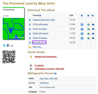

Step 10: Get the Book in the Text Format
First of all, you need to find the book you want to encrypt. There are many websites where you can find it, for example, Project Gutenberg (not a promotion of the website, I just found it to be convenient). Then you need to get the book in either UTF-8 or ASCII encoding. After that, copy the text of the entire book (Ctrl + A) and paste it into a text document (Ctrl + V), name the file however you want and save it.

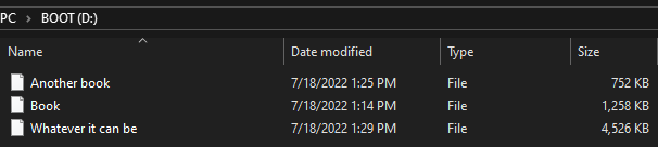

When you're done with the encryption process, move all encrypted books to the SD card. The name and the extension of the books are irrelevant.
I renamed "Promised Land.txt.encr" to "Book"
