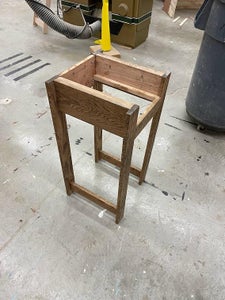

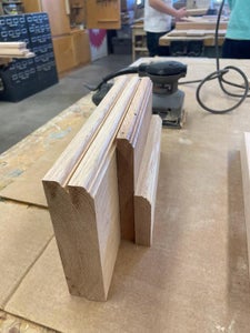

Step 2 was the sanding process. Using the palm sander, each face and each edge was sanded with 120 grit sand paper. After that, I double checked that I had all my pieces finished and done. Finally, I took my sides, my apron, and my back and routed them giving them a decorative edge as seen in image 1.

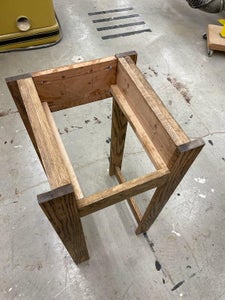

For step 3, holes were made on the drill press for our screws when assembly occurs. We also used the krig jig to make pocket holes for our sides and back and apron. Along with that, all pieces were stained with one coat of dark wood stain and dried for 72 hours.

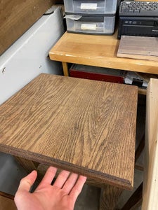

Next, I glued two, 9 inch boards together and let that dry for bout 24 hours. Once dry, I sent it through the planer to a thickness of 3/4 an inch and cut it down to 17inx17in to make it square. Then I added a decorative edge on the router and sanded the entire thing. Following this i added stain to make it match the rest of my table.
