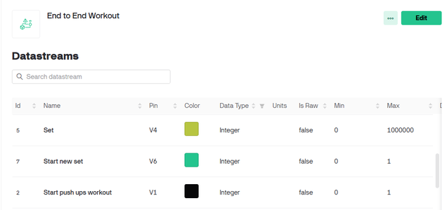

Further more we attached the full code and its dependencies for the End-To-End Workout but we recommend to go over every step in this tutorial and write the code as followed in the detailed steps.

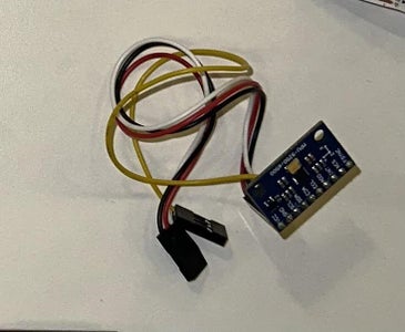

  3. IMU sensor (accelerator)

  3. connect the IMU sensor to: SCL (IO22), SDA (IO21)

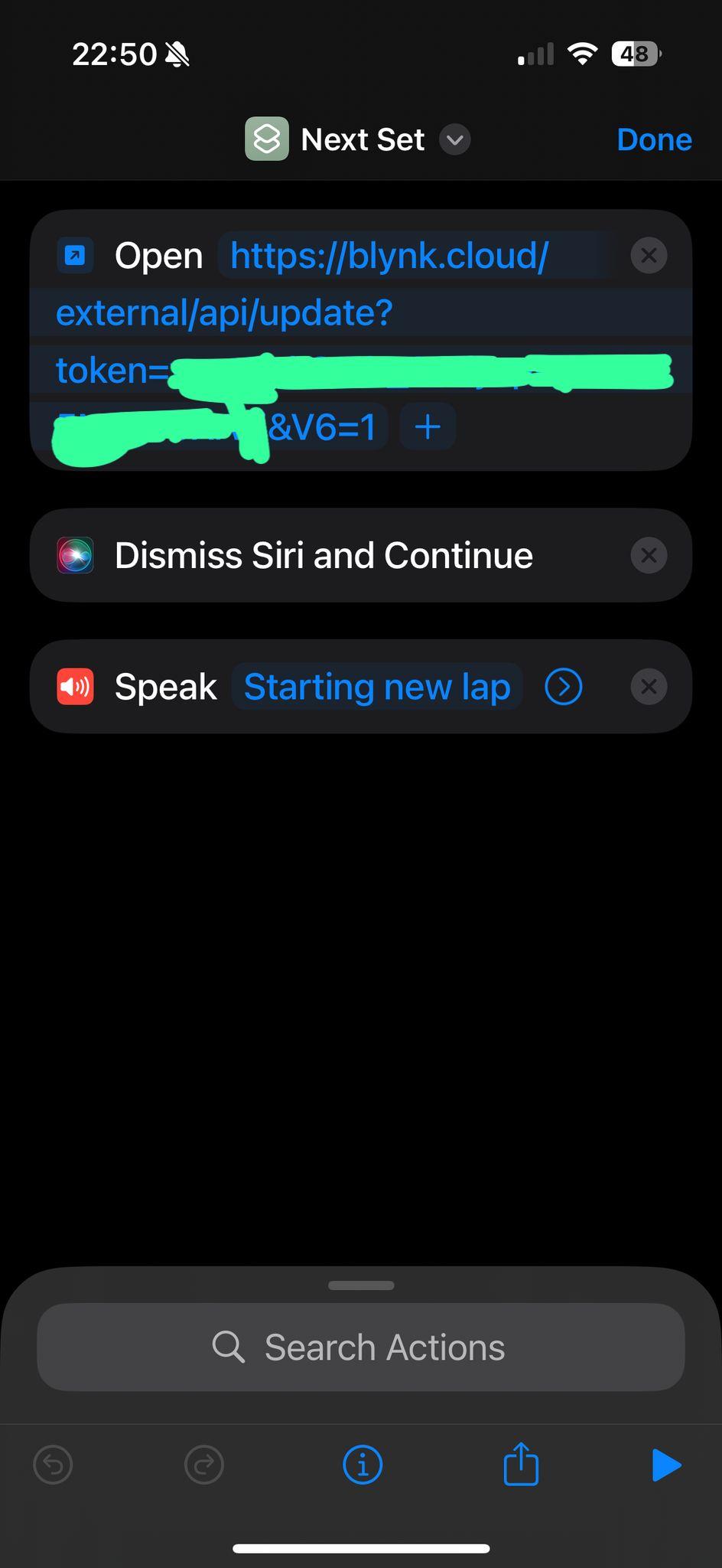

Step 4: Integrating With Control4 System
Intro: Control4 is a sophisticated home automation system that integrates various household devices into one unified platform, providing users with enhanced control over their lighting, audio, video, climate, and security systems. Additionally, it supports voice commands through compatibility with popular voice assistants, and offers robust third-party integration, allowing for seamless operation with a wide range of smart home devices.
In case you don't have control4 system, that's fine, you can skip to step 5.

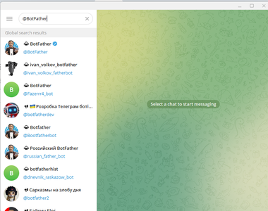

Step 2: Connect to BotFather
To connect to BotFather, search for "@BotFather" in the Telegram app and click on the result to start a conversation.

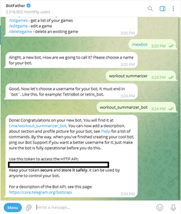

Step 3: Select the New Bot option
In the conversation with BotFather, select the "New Bot" option to start creating your new bot. BotFather will guide you through the rest of the process.
Step 4: Add a bot name
Next, BotFather will ask you to provide a name for your bot. Choose a name that accurately reflects the purpose of your bot and is easy to remember, we chose "workout summarizer".
Step 5: Choose a username for your bot
Lastly, BotFather will ask you to choose a username for your bot. This username will be used to create a unique URL that people can use to access your bot. Choose a username that is easy to remember and related to your bot's purpose, we chose "workout_summarizer_bot".
And that's it! With these five simple steps, you can create your very own Telegram bot that you will use to send the workout summarize to the user.
Now you need to extract the token from the last message that BotFather has sent you (see attached image) so you can use it to send requests to the telegram API that will send messages to the user via the bot.

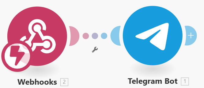

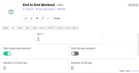

Step 6: Creating a Make.com Automation for the Telegram Bot
First you will need to create an account in make.com. Next we need to create a new scenario, in your make account go to the Scenarios section and create a new scenario.

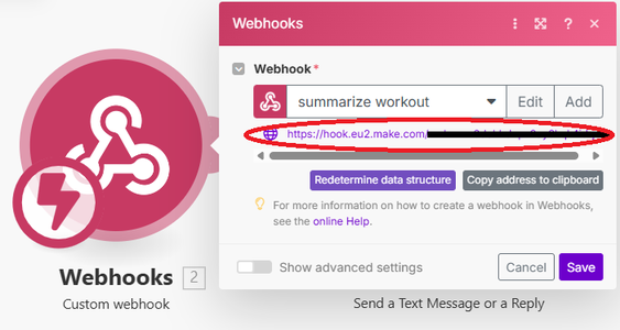

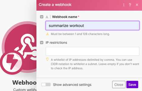

Now we need to create a new Webhook, choose a name for the webhook, we chose "summarize workout".
Next you will receive an URL, we will use it to send the workout data from the esp32 to the telegram bot.

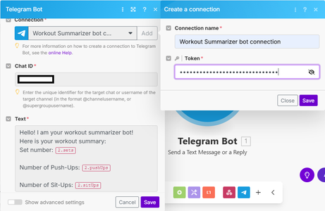

Now you need to add to the scenario the Telegram Bot app and configure it:
First we need to create a connection to the telegram bot using the token from step 2 (see attached photo).
Secondly we need to configure the chat id of the user using the chat id that we got from step 2 (see attached photo).
Lastly we need to create the workout summary message that the telegram bot will send to the user:
"Hello! I am your workout summarizer bot!
Here is your workout summary:
Set number: {{2.sets}}
Number of Push-Ups: {{2.pushUps}}
Number of Sit-Ups: {{2.sitUps}}"
This way the workout data that the esp32 will send to Make can be used in the summary message.
Now you need to connect the Webhook module to the Telegram Bot module, drag the plus button in the Webhook module and connect it to the Telegram Bot module (see attached photo).

Now you need to extract the Make.com url of the webhook, click on the webhook in your scenario and copy the address (see attached photo).
Next you can send your workout data to Make.com url (that you just copied) using a GET request with the parameters sets, pushUps and sitUps as seen in the code below.

// send get request
int httpCode = https.GET();
// handle get response
if (httpCode > 0)
Serial.printf("GET response code: %d\n", httpCode);
if (httpCode == HTTP_CODE_OK || httpCode == HTTP_CODE_MOVED_PERMANENTLY)
String payload = https.getString();
Serial.println(payload);
// get request failed
else
Serial.printf("GET request failed, error: %s\n", https.errorToString(httpCode).c_str());
https.end();
else
Serial.println("Unable to connect to make.com");
delete client;
else
Serial.println("Unable to create https client");

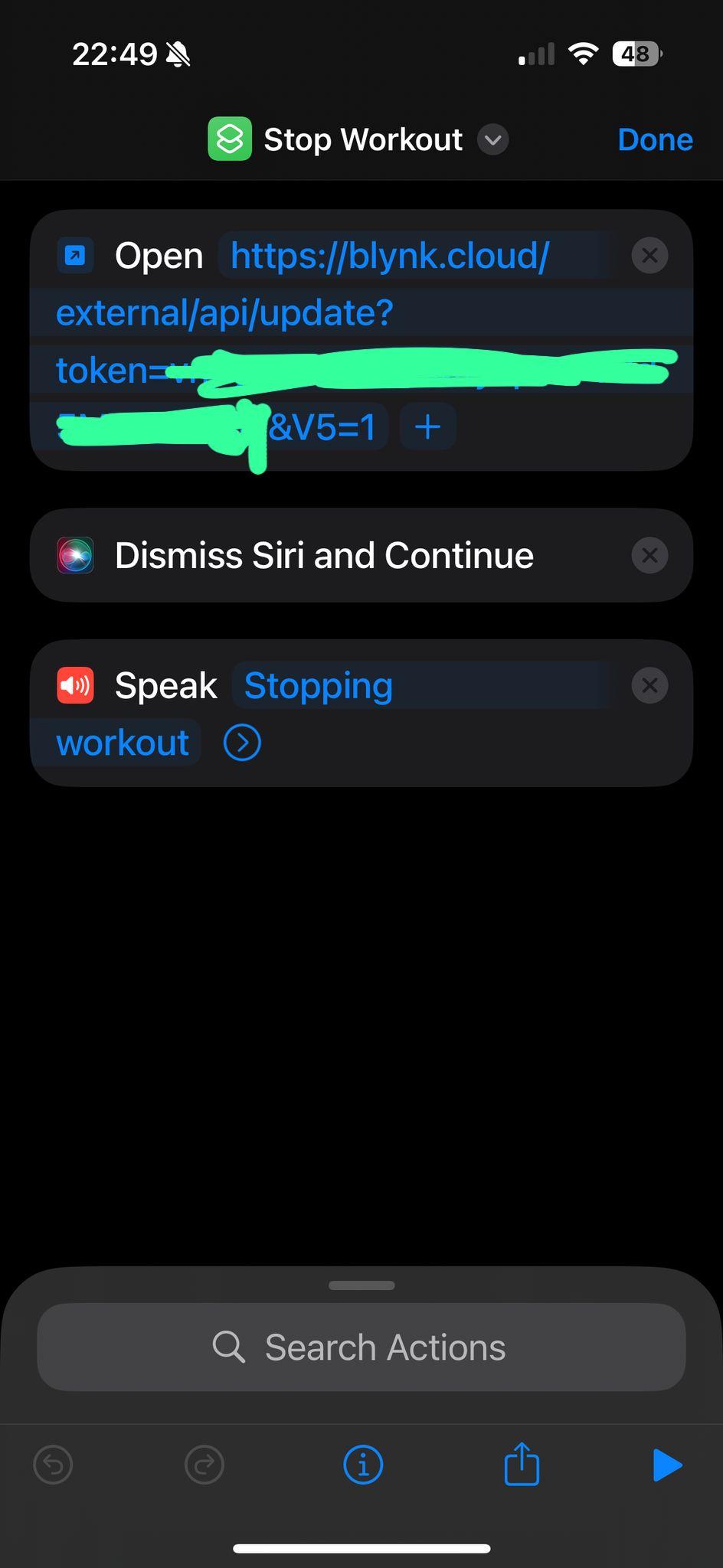

Step 7: Integrate With Shortcuts and Siri
In order to have the full experience, we recommend to create 4 new shortucts.
  1. Start Sit-ups
  2. Start Pushups
  3. Next Set
  4. Stop Workout
Each one can be controlled from siri and give you a feedback after the operation is finished.
Each operation is sent to blynk and updates the esp32 modes.
How to create a shortuct?
  1. In your Iphone, search for "Shortcuts" app
  2. Click on the + button in order to create your new shortcut
  3. Select "Add action"
  4. Search for "URL"
  5. Press the "URL" placeholder and paste the following URL: https://blynk.cloud/external/api/update?token={your_blynk_token}&V{insert_the_relevant_id_from_the_photo}={insert_the_relevant_id_from_the_photo}
  6. Congrats! you can start fitting up!
Step 8: Integrate With Blynk
We want to control and display the workout progress to the trainee, that's when Blynk will be useful.
Open Blynk website and create an account. Now head over to the Developer Zone section and create a new template, then add to this template a newdevice. Next open the Datastreams and add 7 new datastreams:
  1. name: Start sit ups workout, pin: V0, data type: Integer, min value: 0, max value: 1, default value: 0
  2. name: Start push ups workout, pin: V1, data type: Integer, min value: 0, max value: 1, default value: 0
  3. name: Number of push ups, pin: V2, data type: Integer, min value: 0, max value: 100000, default value: 0
  4. name: Number of sit ups, pin: V3, data type: Integer, min value: 0, max value: 100000, default value: 0
  5. name: Set, pin: V4, data type: Integer, min value: 0, max value: 100000, default value: 0
  6. name: Reset, pin: V5, data type: Integer, min value: 0, max value: 1, default value: 0
  7. name: Start new set, pin: V6, data type: Integer, min value: 0, max value: 1, default value: 0
Now head over to the Web Dashboard section and add 4 Switch widgets to the dashboard, one for each switch datastream (Start sit ups workout, Start push ups workout, Reset and Start new set), configure each switch widget to its corresponding datastream and name them accordingly (see attached photo).
Next add 3 Number Input widgets to the dashboard, one for each number input datastream (Number of push ups, Number of sit ups and Set), configure each number input widget to its corresponding datastream and name them accordingly (see attached photo).
Download the Blynk app on your phone and follow the same steps in order to create the same workout dashboard in your phone.

if (command == 1)
// turn on water tank and the light in the shower at the end of the workout via control4
turnOnWaterTank();
turnOnLightInShower();
// send final set (of workout) summary to telegram bot
sendWorkoutDataToTelegramBot(numberOfPushUps, numberOfSitUps, lastSetCount);

Step 9: Push-ups and Sit-ups Counting Using IMU
The main feature that is the core of the project is triggering the push-ups and sit-ups workout count.
We do it using an accelerator that checks if a push-ups or sit-ups set in the workout has happened.
In order to prevent spamming the blynk app, we added a check if we detcted a movment more than 3 times to be sure that it was actually moved. it helped us prevent wrong counting and be sure that the values are correct and works as expected.
How to intergate:
use the accelgyro library
#include "I2Cdev.h"
#include "MPU6050.h"
Also you should define those variables to make sure the usage of the accelgyro will work.
// IMU configuration
#define OUTPUT_READABLE_ACCELGYRO
MPU6050 accelgyro;
// IMU axis configuration
int16_t ax, ay, az;
int16_t gx, gy, gz;
// accelerator state variables
float yAxisAccelerator = 0;
int countDirectionMovement = 0;
// workout state variables
bool isPushUpsWorkoutStarted = false;
bool isSitUpsWorkoutStarted = false;
int numberOfPushUps = 0;
int numberOfSitUps = 0;
int lastSentNumberOfPushUps = 0;
int lastSentNumberOfSitUps = 0;
// workout send time interval variables
unsigned long lastPushUpsSendTime = 0;
unsigned long lastSitUpsSendTime = 0;
unsigned long sendInterval = 500;
Add this to your setup function
// add to setup function
accelgyro.initialize();

Step 12: Using End-To-End Workout
Now that all is done, and you are ready to go, you can select your desired workout:
  1. Push-ups
  2. Sit-ups
If Sit-ups has been chosen, put the strapped wrapping box on your belly.
If Push-ups has been chosen, put the strapped wrapping box on your back.
You can start each mode from blynk clicking on the relevant "start" buttons, or you can create the siri shortcuts and use them for hand free usage.
In order to know that the workout has been started, you can see the small blue led turning on, which signs that the workout can start.
In case you want to use the "Sets" feature, you can use it only through siri shortcuts, that's due to our understanding that the trainee won't want to stop the entire workout in order to start the next set, and it will be much easier to do so through siri, otherwise he can just start and stop the whole workout through the blynk app.
You will pay attention that after every success push-ups/sit-ups you will hear a voice and the strapped wrapping box will be shining for a friendly feedback about your success in your workout.
At the end, you can turn off the workout by pressing on the button again, or asking siri to "stop workout" and the blue led light will be turned off.
In addition, at the end of each set (or ending the entire workout) a summary of your workout will be sent to the telegram bot, giving you the full workout data.
Making your life easier, when ending the workout the water tank and bathroom light will be turned on using control4 system.
For more visual explanation, please watch the video attached in the explanation.
