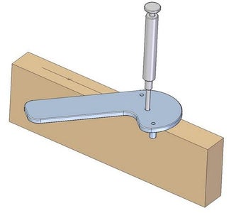

So now you have one top piece with 3 holes and rounded ends, and two bottom arms. I oiled the wood with boiled linseed oil and allowed to dry. I then hammered the pivot pins into the top piece. If the M6 bolt was also used in theory you could use the tool like this (picture 3) but the arms need to also be placed. Also fitted with the hammer but gently (picture 4).
I used initially a M6 threaded bar with a slot cut in it but replaced it with an M6 bolt that had an internal allen key fitting. A normal bolt of some kind would do. I sharpened the end up on the grinder enough to mark timber.
This bolt was then screwed into the top piece enough to project slightly out of the other side by about 2mm.
Step 7: In Use
Generally this is to be used on timber 60mm wide or less. As you can see from the photos you unfold the arms so the flat sides run along each side of the wood to be marked. By applying pressure to each arm centralizes the tool and with a little downward pressure will score the workpiece as you slide the tool along.
As you reach the end of the workpiece, because the arm is an extension of the pivot pin, allows the tool to still run centrally to the end.
This was tested on wood and aluminium channel and then measured with vernier callipers to check accuracy. Spot on.
