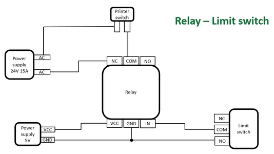

I used a limit switch and a single channel module so that my ender 3 will automatically shut down after the print is done. I always had to keep track of the time when I put any design for print and since I didn't want the printer to stay on unnecessary for longer period of time, I was never able to put the prints overnight. This is my version of auto shutdown ender 3.

Step 2: Connection
Do the connection as per the schematic attached above. For the power supply, i am using 5V adapter. With the female power jack, you can turn on/off the relay whenever you want.

What this G-code does is that after the print is over, the nozzle will move 10mm upwards and will wait till the nozzle temperature reaches 40°. After the nozzle temperature reaches 40° the bed will move forward and it will hit limit switch and the printer will shut down. In case you stop the print in between, the bed will slide backwards towards the Y-axis limit switch.
