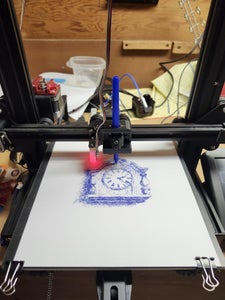

I started 3d printing during the pandemic, and I bought a few Ender 3 V2's to occupy my time. Because I moved on to a better printer, my Ender 3 was gathering dust. I started thinking to myself what I could do with that printer. I had a few ideas like turning it into a better 3d printer, but I didn't feel confident in my design skills. I am relatively new to CAD. I have done a few small projects in Fusion 360, but I wanted to see how far I could take my skills while also designing something cool. I thought it would be cool if I could use my Ender 3 as a drawing tool. Ender 3's are accurate to 1/10th of a millimeter or so, so it should be capable of very detailed pictures with the right software and pen tip.
I came across a YouTube video about the PLTR V2 -- another plotting toolhead for the Ender 3. There were a few issues with that design for my particular use-case. My design was inspired by certain aspects of the PLTR V2.
My Ender 3 is running a custom firmware called Jyer's Marlin, and I have it configured with a BL-Touch bed probe. I did not want to flash stock firmware to the printer, and I still wanted to use my BL-Touch. I designed a mostly 3d printed pen plotting toolhead for the Ender 3 V2. It should also fit Ender 3's as well. My toolhead is smaller than the PLTR V2, and it will allow you to use the BL-Touch, CR-Touch, or similar bed probe that is mounted on the left side of the gantry.
Because of these design constraints, my pen plotting toolhead is smaller than the PLTR V2 and will hold pens up to 11mm in diameter. This is big enough to support most pens and some smaller markers.
I am entering this Instructable in the 2025 Build-A-Tool contest. The 3d printed parts were entirely designed in Fusion 360. I have made the files open-source on my Github if you would like to download them.

Step 8: Install Toolhead on the Gantry
The base plate has 2 holes for attaching the plate to the gantry. For the right hole, use an M3x8mm screw. For the right hole, stick a M3x12mm screw through it and the screw should poke through the back of the plate. Secure it with an M3 nut.
Step 9: Calibration
Here are my recommended calibration steps. The exact numbers may vary depending on your printer. You may need to do a few test drawings to figure out what works best for you.
  1. Using the prepare menu, home all the axes on your printer. At the end of calibration, it's pretty likely that your Z height will be ~13mm unless you have specified a different home position.
  2. Using the Move controls on the printer, set the Z axis to ~0.5mm.
  3. Insert a pen and let it touch the build plate. Turn both screws in the pen carriage to secure the pen in place.
  4. Lift up on the pen slightly and slide of paper over the build plate. I secure the paper to the build plate with binder clips.
  5. Using the controls on the printer, you can manually move the head around for a quick test. Another option is to disable the stepper motors and move the gantry and bed by hand. Assuming the lines look nice and solid, your printer is calibrated.
If your pen doesn't make contact with the paper, rerun the calibration steps above but use a slightly higher number on the Z in step 2. 0.7mm or 0.9mm may work better depending on pen and paper thickness. If the paper tears or rips, you have too much pressure on the pen, and you could try 0.3mm or 0.1mm in step 2.
