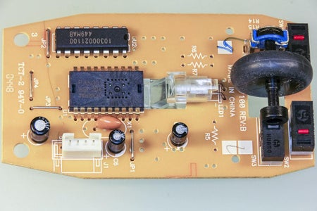

Step 2: Disassemble Mouse
Disassemble the mouse and unsolder left click button. Take wire and solder it to the button and to the left click button terminals on mouse PCB. Then assemble mouse.
Step 3: Screw Button to the Time Lapse Holder and 3D Printer
