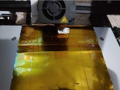

Step 9: Belt Installation
The belt (regardless of which option you chose) can then be fed under the axle, over the two BeltSlide's (inside the small teeth that hold it), under the other axle, and back over the bed.
DIY Belt SizingYou will cut the steel shim based on the width between the two guard bumps on the rollers and the length a little longer than necessary to go around the rollers, over the bed and over the belt slides.
Note that the steel shim is super sharp when cut, but you should be able to file it down.
You will want to tape it tight and straight (if either side is longer than the other, prints won't work well). Then run Kapton tape lengthwise over the belt to cover it for better print adhesion.
Less deformities in the tape is better as it will increase adhesion and lower model warp.

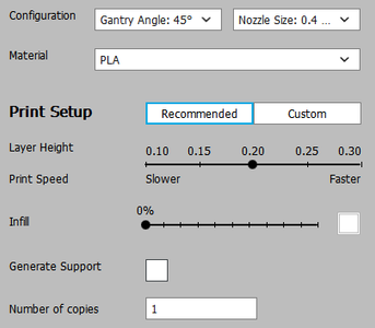

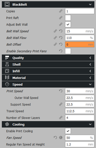

Step 13: Slicer
You will need to install BlackBelt Cura to do belt printing. Once installed, find the install directory (C:\Program Files\BlackBelt Cura 3.6.0\resources on Windows) and copy/paste the Config folders I included here. This will prompt to overwrite a file, say yes. The config I included overwrites the BlackBelt default one.
This should be fine since most people who can afford a BlackBelt probably aren't making this ;)
Also worth mentioning is that the included Cura file is a zip file. Thingiverse won't allow this as an upload type so I've simply added the .thing extension on the end. Just delete the extension when you want to extract the zip.
