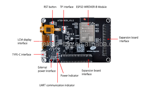

Introduction: Energy Monitor, Using API Calls on a ESP32 (WT32-SC01)
I purchased a WT32-SC01. This is a ESP32 development board with a touchscreen attached. It has onboard WIFI and Bluetooth. This is a very nice and compact designed board. Much easer to use then a separate board and screen.
In my fuse box I have a smart meter which allows me to monitor my gas and electricity usage trough my smartphone or a website. I didn't always want to open my app and wanted to see the usage live, I decided to buy this device and see if I could hook it up to my smart meter.
This instructible can also be used if you just want to know how to make a design for the screen using a drag and drop UI designer, or how to make API calls, or if you just want to know how to get the thing working.
Note, if you already own the WT32-SC01, that's fine. But I recommend don't buy one, buy the WT32-SC01 plus.
The plus has lots more memory and some other improvements.

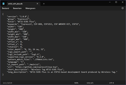

Open notepad or other text editor you have and make a text file with the following content:
  "version": "1.0.0",
  "group": "Espressif",
  "title": "WT32-SC01 Plus",
  "keywords": "Espressif, ESP-BOX, ESP32S3, ESP WROVER KIT, ESP32",
  "width": "320",
  "height": "480",
  "width_min": "320",
  "height_min": "480",
  "width_max": "320",
  "height_max": "480",
  "offset_x": 0,
  "offset_y": 0,
  "rotation": 0,
  "color_depth": "8, 16, 16 sw, 32",
  "lvgl_export_path": "",
  "lvgl_include_path": "lvgl.h",
  "supported_lvgl_version": "8.2.0",
  "pattern_match_files": "./CMakeLists.txt",
  "language": "C",
  "ui_export_path": "./main/ui",
  "url": "https://github.com/espressif/esp-bsp",
  "short_description": "Wireless Tag WT32-SC01 Plus",
  "long_description": "WT32-SC01 Plus is an ESP32-based development board produced by Wireless Tag."
Save this file in the folder you previously made and name it: wt32_sc01_plus.slb
This tells Squareline studio what the display looks like.
This file works for the wt32-sc01 and the plus variant

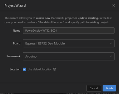

Step 5: Visual Studio Code
If you have not done already, go to visual studio code and create a new project using PlatformIO
  • Enter a name
  • Board: Espressif ESP32 Dev Module
  • Framework: Arduino
