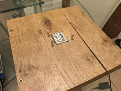

The concept is simple, the lamp glows a colour that represents the instantaneous electricity usage of the house. Blue obviously means good things whereas red means you're an evil environmental sadist (or perhaps baking some muffins).

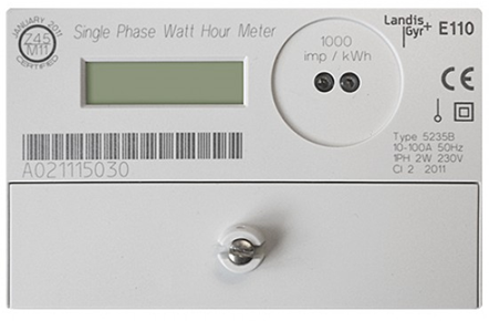

Most digital electricity meters have a little red light that flashes 1000 times per kWh used. Hence the rate of flashing represents the rate of energy usage (ie. the power consumption).
It’s simple enough to bluetack a photoresistor over this and write a simple program to run on an Arduino to detect the flashes. By using a RF transceiver unit we can broadcast these flashes to the neighbourhood. Here’s the transmitter code on Github.

We use PWM at 62.5kHz to modulate the current through the LEDs. A buck converter circuit is employed for each LED. This is better than simply PWMing the LEDs directly from the 12v supply through a resistor because it’s much more efficient.
When the transistor switches on, the current through the LED ramps up due to the 220uH inductance. When switched off the current freewheels through the diode and the LED current decays. This gives a classical triangular waveform as shown in the figure.

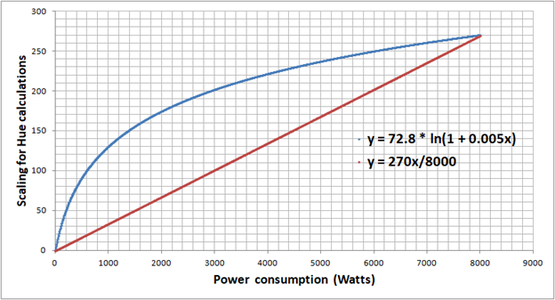

  • I found some code on Stackoverflow to convert HSV (Hue, Saturation, Value) to RGB values. This makes it a lot easier to generate the colours. We always want the saturation (S) and brightness (V) to be maximum. This leaves just one variable (H) to adjust. Compare this against an RGB setting. What values of R, G and B do you need to make yellow? How do you gradually adjust these values to transition from orange to red!? The HSV colour system makes things straightforward.
  • What colour do we choose for what power? Initially I tried a linear scaling however I later decided a logarithmic scale would be better. I wanted to see the difference between 50W and 100W whereas I wasn’t so bothered about 5000W and 5050W. I felt like it’d be better to have higher resolution at lower power usages and I’m pleased by the results.

I had a smart meter installed and it has 2 IMP lights next to each other. One 2000/kWhours and one for 2000/kvarh. Initially I had some strange behaviour. I then realised my photoresistor setup was too sensitive and capturing flashes from both IMP lights because they were close to one another. I switched the pull down resistor in the Tx unit for a 47K one and that fixed the “cross talk” issue.
