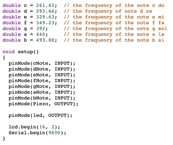

Step 8: Part 2 of Coding
The started of the this picture coding I did the frequency of the notes and for each of them. Then void setup put in pin mode then the note you using and then input. Do that to the rest of the notes. For the piezo write pin mode then piezo then this time its going to be output. Then for the LCD write lcd.begin(16, 2); 16 and 2 are the places you put the wire to connect it. Then next line add Serial.begin(9600);

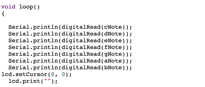

Step 9: Part 3 of Coding
For void loop write Serial.println then (digitalRead( the note you want to us like cNote)); do this to the rest of the notes it would look something like this.
Serial.println(digitalRead(cNote));
Serial.println(digitalRead(dNote)); Serial.println(digitalRead(eNote)); Serial.println(digitalRead(fNote)); Serial.println(digitalRead(gNote)); Serial.println(digitalRead(aNote)); Serial.println(digitalRead(bNote));
Then for the LCD write lcd.setCursor(0, 0); then in the next line wri

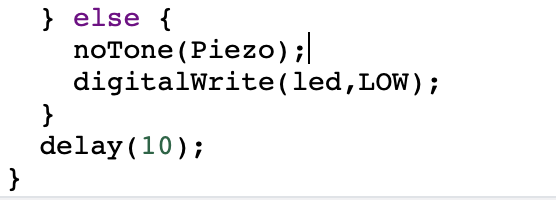

Step 11: Part 5 of Coding and Last Part...
Ones you have done all the else of the notes you are almost done with only a few lines of code left. start of with writing else and noTone(Piezo); then next line write digitalWrite(led,LOW); then the last part you need is }
delay(10); } and you are done!!!!!
