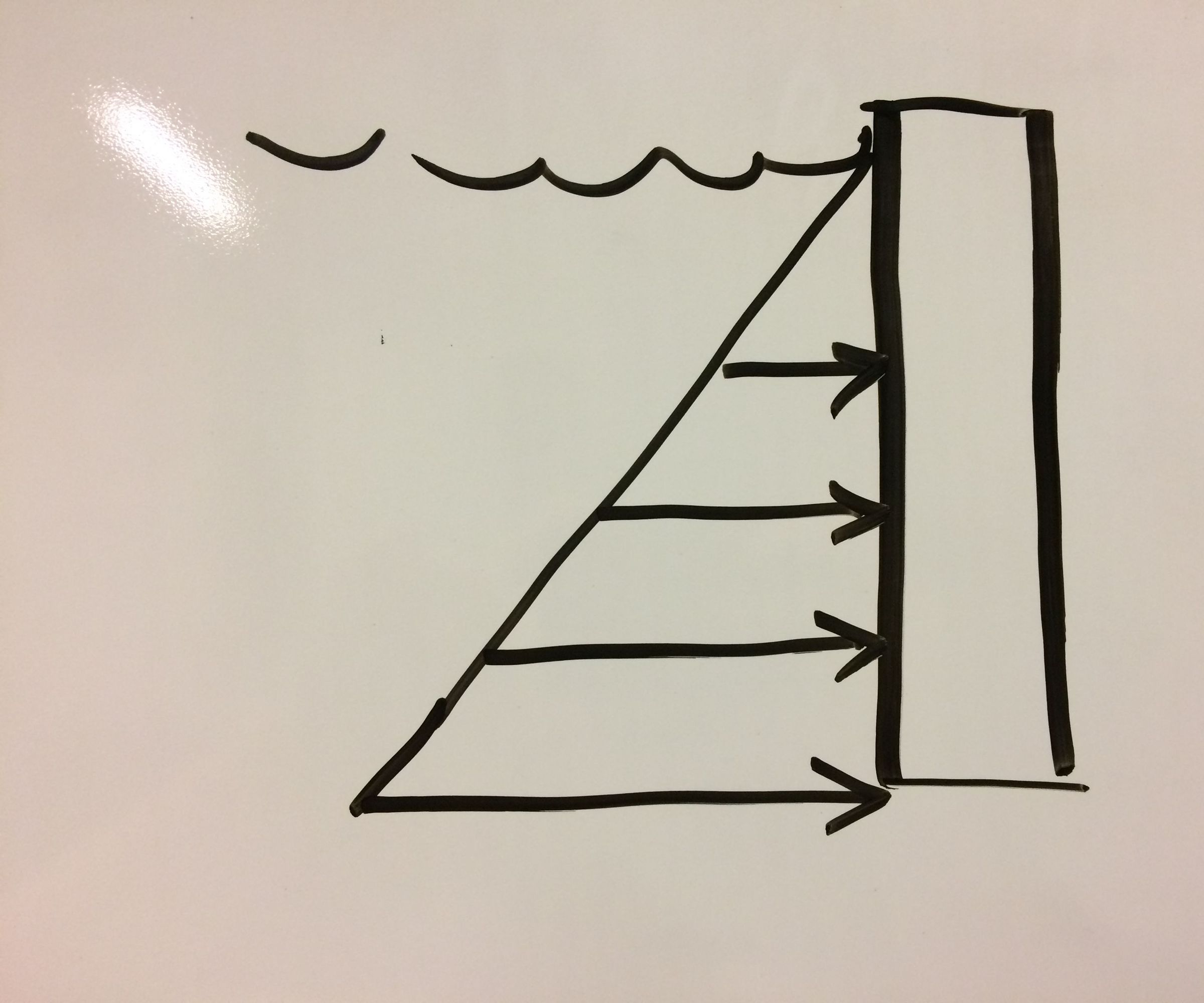

Step 2: Read and Sketch the Problem:
Now that you have a basic understanding of how water pressure effects a dam, you can approach the problem.
1. Read your problem so you know exactly what you are solving for.
2. Sketch the dam and force acting on the dam
The sketch of the force can be thought of conceptually first, keeping in mind what you learned about water pressure. Since the water pressure increases proportionally to the depth, force, which is drawn as an arrow pointing at the object the force is acting on, is increasing as well. The force can thus be drawn as a triangle of arrows increasing in size.
For the purpose of solving a problem, however, the force is treated as an average of all the arrows of the triangle which acts at the centroid (geometric center) of the triangle which is at (h(height)/3). (label the force F)
Note: we will use this problem as a example.
What is the force acting on a 25 meter width dam and water depth of 15 meters?

Step 4: Derive the Nessacary Formula:
To understand the formula you must think back to when were imagining swimming in the pool. The water above you caused an increase in pressure. Only, in this problem, instead of the water being above you, it is acting on the surface area of the dam. With that in mind, we can understand the force exerted on the dam by the water is:
Force= Pressure (x) Area
We also know that:
P= rho (x) g (x) h
A (referring to the surface area in contact with the water)= (h (x) w) /2
Finally after multiplying area and pressure, you can write down the formula:
F= (rho)(g)(h/2)(w (x) h)
