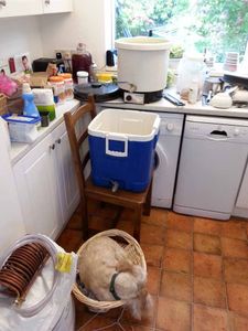

Next you need a source of hot water. A lot of hot water. You will lose a lot of water, absorbed by your grain, evaporated off or just stuck at the bottom of you tun. Typically, you need about 9 gallons for 5 gallons of beer. You can buy dedicated boilers for both heating the water and boiling the wort. One can be used for both but it is easier to have one for each. This certainly isn't necessary when starting. One warning, electric elements can become covered in gunk when boiling the sweet wort and over heat, this causes them to cut out. For this reason I prefer to boil my wort over gas.

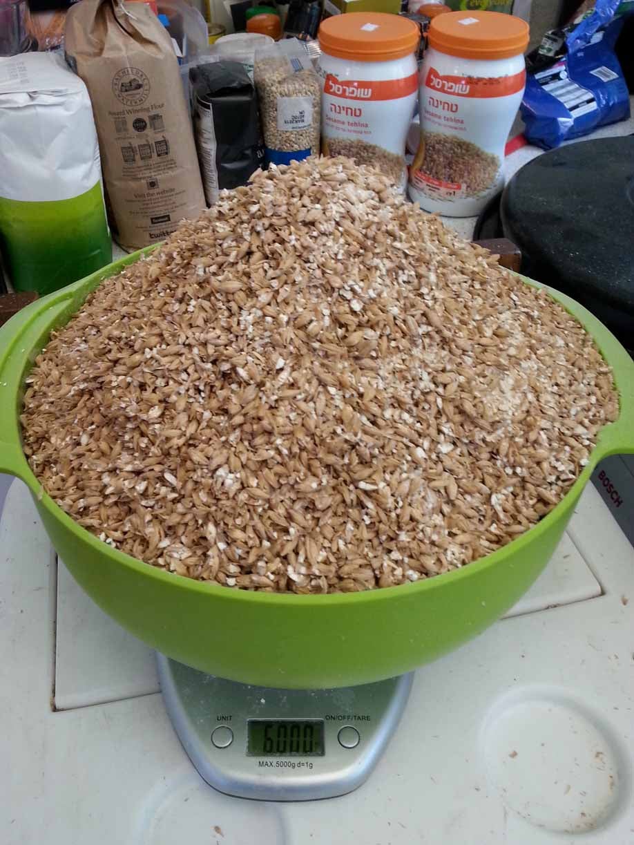

Grain Bill:
6lb Pale malt, Marris otter
1lb Crystal malt EBC = 120
8oz Torrified wheat malt
8oz Biscuit malt

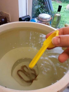

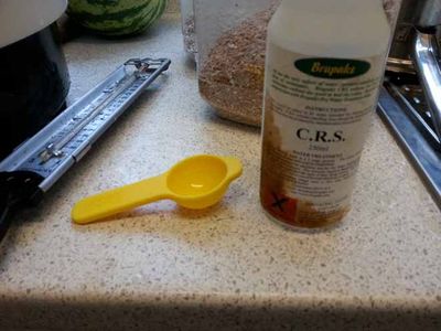

So I use water straight out of the tap, I don't have a great water supply but off flavours will largely boil off. However, for brewing English ale we want to "Burtonise" our water. This means getting it close to the water of Burton-on-Trent. There are many complicated discussions on full water treatment but the simplest is using a combination of CRS and DLS and it works great.
Water treatment is completely dependant on your water supply but by contacting you water authority they will provide you all the info you need.
Water treatment is complicated and often not as necessary as some will suggest. I wont go into the calculation here as if its your first time just ignore water treatment. It's complicated and there are more important concerns with you first brew. The good news is once you have done the calculation it's the same every time (assuming the same type of beer). For my water I need 10ml CRS which is poured into the boiler. Maybe a topic of a future Instructable...

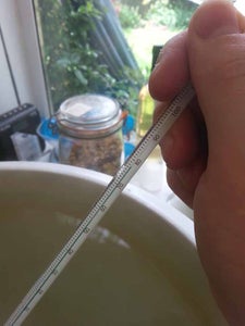

I then heat the water. To properly mash the grains, which is when the carbohydrates are converted to fermentable and non-fermentable sugars, they need to be close to 66C. Since they are starting at room temperature the water needs to be heated to 76-77C.

Ok so to prep the mash tun, I pour in a couple of kettle fulls of boiling water. This is to warm the whole thing up otherwise we'll lose a lot of heat when adding the grains and hot water.

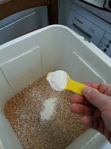

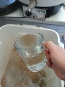

Once warm, I measure out the grains and pour them into the tun. Lastly I add 2 tablespoons of DLS. This is a white powdery stuff (skip if you are not performing any water treatment). Now we add the correct amount of water for our grains. The water-to-grain ratio is approximately 1.5lt per pound, meaning we need 12lt* of water for our 8lb of grain (sorry about the mix of imperial and metric!). This is important as too much and the mash will be thin and too hot, and too little and the mash will be thick and too cold. Thin mashes will not efficiently convert the sugars into fermentables. A thick, cold mash will convert too efficiently and all your sugar will ferment to a very dry high alcohol beer. We want somewhere in the middle, a nice mix of fermentable and non-fermentable sugars to give the right balance of sweet to bitter.
I use a measuring jug and pour into the grain. Once all the water is added I give it a good stir making sure to break up any dry pockets. Measuring the temperature it's a perfect 65-66C.
Close the lid and cover in towels. Leave this to mash for 90min.
*I made a stupid mistake in my conversion of units and used 13.5lt not 12lt. I think this is the reason for an efficiency of only 68%.

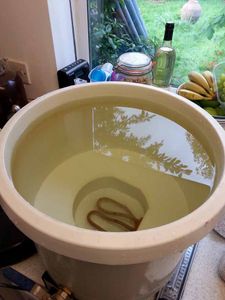

After 45min it's time for the second addition, 0.5oz EKG and 0.5oz Fuggles. Also add a teaspoon of irish moss. This is seaweed and helps clear the beer. I also throw in my wort chiller coil. A large copper coil. After the boil, cold water is passed through this coil and cools the wort to room temp in about 30min. These are really useful but not necessary and I had no problems leaving the wort to cool overnight. But its nice to have.
After 60min turn off the gas and return to the kitchen. Careful carrying 4 gallons of boiling wort! (1 gallon lost to evaporation.)
Step 6: Cooling, Specific Gravity and Yeast Pitching
Now the boil has finished I add the last hop addition, 1oz of Fuggles for 15min. After the time is up I turn on the cooling water and with a thermometer probe monitor the temperature until it reaches about 25C.

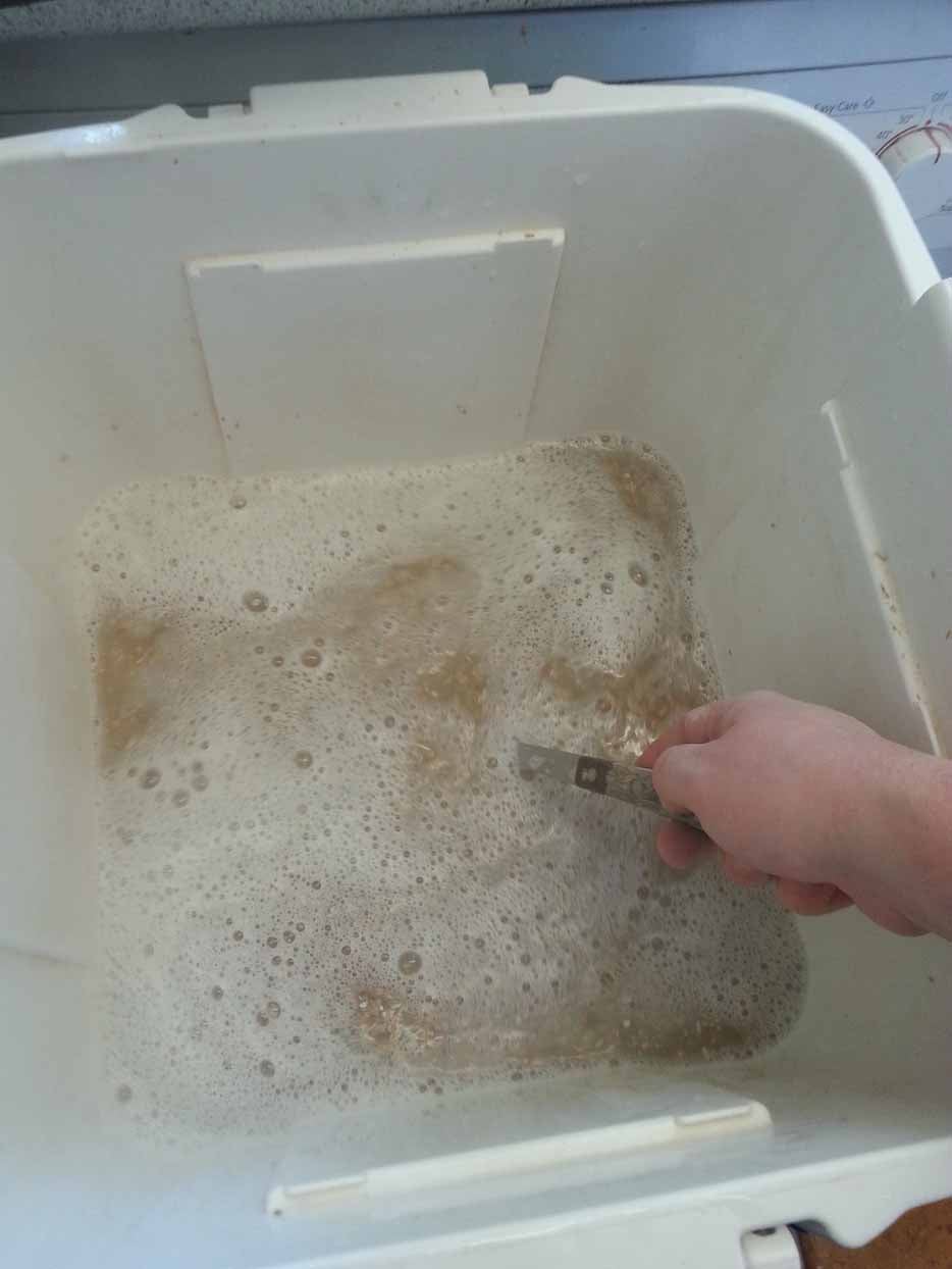

It is important now to comment on sterilisation. This can not be over emphasised. There is nothing worse then making a batch only for it to go off. I use a combination of two chemicals. To clean the worst grime I use VWP. This is a chlorine based agent and is very potent. The benefit of this is it will kill everything. The down side is it requires a thorough rinse, which if your not using boiled water can just reinfect your clean equipment. So once the worst grime is gone I rinse off the VWP and with a 1lt spray bottle (the type used for watering plants) cover the surface with a solution of Star San. This is an acid based steriliser, therefore it is important to ensure all VWP is removed or its alkalinity will neutralise the Star San. The great thing about Star San is it doesn't require rinsing, just spray the surface and the cooled wort can be poured in on top. Using this I have never had a infection problem.
So now with my cooled wort and a sterilised fermenter I can transfer the wort to the fermenter. But first we should measure the specific gravity of the beer. This is a measure of the amount of sugar in the liquid. I have both a hydrometer and refractometer. The refractometer is a cheap Chinese ebay purchase and is surprisingly accurate. Just put a drop of wort on the glass and hold it up to the light. Both the hydrometer and refractometer come out at about 1.038. Not too shabby, lower than predicted by BeerSmith but as commented earlier probably a result of stupidly using too much mashing water. Now the soon to be beer is poured into the fermenter and the yeast is pitched.

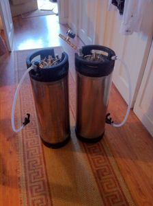

For those who want to invest a little more I couldn't recommend cornelius kegs enough. They are expensive but worth every penny. I also recommend either buying one converted for S30 gas or converting it yourself. The benefit of these kegs are: they are made of steel, robust, never leak and no secondary fermentation. They were originally designed for holding coke and pepsi in pubs so are professionally designed and are better then any homebrew alternative. If you want to get more professional they can easily be incorporated into a beer line with proper gas regulators and taps... I own 3.
I store the beer for about a month in a plastic barrel then once the beer is clean and lovely I transfer it into a corny. Inject some gas through the S30 connector and pour away.
