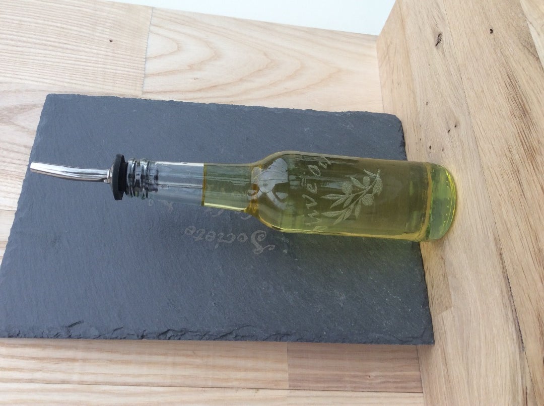

Wine bottles etch very well and it is my plan to etch and then reuse them of other uses in the home.

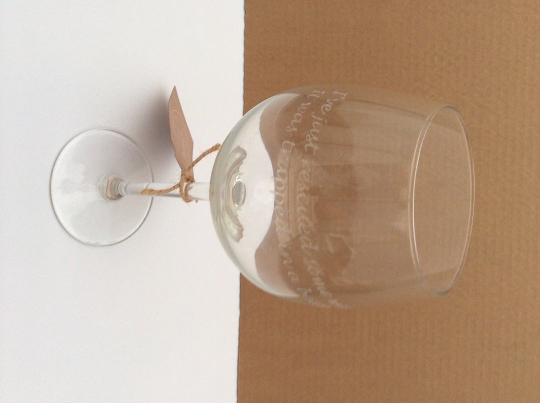

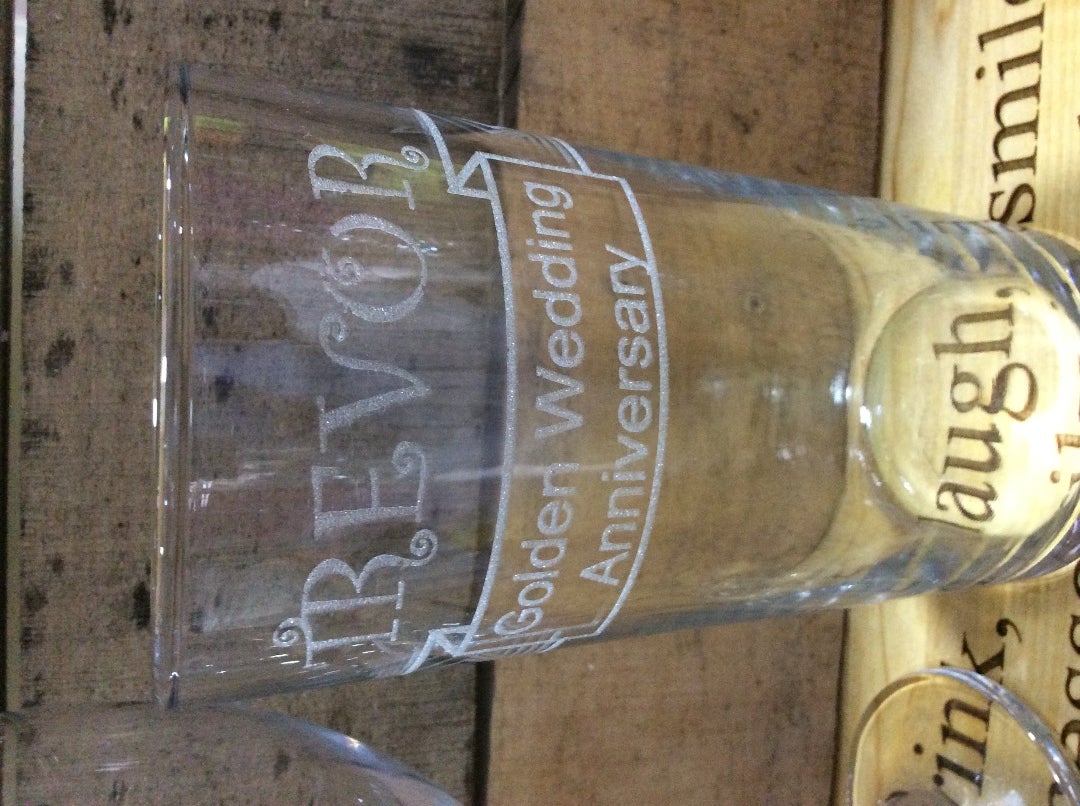

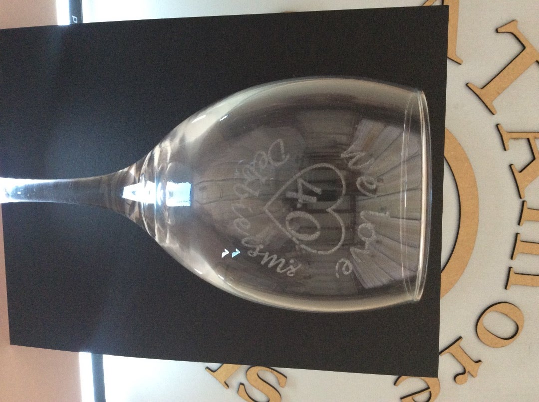

Because it is not something I do often I decided to do a large number of rotary engraved objects in one go.
I engraved wine, beer and cidre bottles, carboys, some drinking bottles, wine glasses and a couple of Maglites. My practice ones were all wine bottles because they are cheap and I have plenty (any excuse for a glass or three:)
  • Bottles are easy to do but can be difficlut to hold.
  • Carboys need a special stepped holder. (see pictures)
  • Water/drinks bottles usually acrylic or PET but check before starting. Don't touch anything with chlorine in them for fear of damage to machine.
  • Maglites are easy to etch and look really really cool.
  • Wine glasses, you only need to hold the base as there is no pressure on the actual glass by the laser itself.
