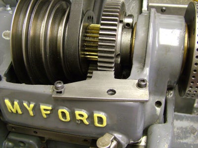

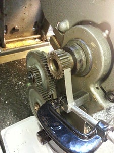

The spindle on my lathe has a chuck on one end, and a 25 tooth gear-wheel (cog) on the other. The gear-wheel is used to make sure that there are 25 equal-angle steps.
A springy strip of steel was clamped (with a G clamp) onto the lathe's cover support-rod. The steel rested gently on the gear teeth and the spindle (ie the chuck) can then rotate freely in one direction, but is stopped from rotating in the opposite direction by the springy steel strip catching on one of the teeth. Almost any bit of thin metal could be used; there is virtually no force on it.

  1. Rotate the chuck until the strip drops off a gear tooth into the gap
  2. Engrave the line with the cutting-tool (see later)
  3. Back-off the cutting-tool
  4. Rotate the chuck until the strip drops off the next gear tooth into the gap
  5. ... ... etc. etc

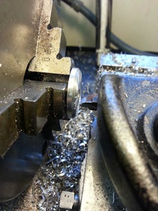

I removed my 4-way tool-post and went back to my 'elephant foot' tool-post.
I made the cuts by putting the cutting tool (a sharp HSS 60 degree threading tool) on its side in the tool-post, digging the tool into the aluminium (by 20 divisions on the top-slide dial) and pulling it away from the lathe axis (ie towards me) by rotating the cross-slide handle.
I was not very concerned about the engraved lines being exactly radial, so I did not spend much time setting the point of the cutting tool on the lathe centre-line. To get radial lines, this alignment is critical.

  1. Dig the tool into the aluminium by rotating the top-slide by 20 division on the top-slide dial.
  2. Cut the line towards me, by rotating the cross-slide handle until the tool leaves the aluminium.
  3. Move the tool away from the workpiece (by rotating the top-slide handle through about 30 divisions).
  4. Move the tool back towards the centre of the workpiece until the dial is zeroed.
  5. Rotate the workpiece by one 'gear tooth'.
  6. ... ... Keep going for all 25 teeth/lines.

  • The chuck should be rotated until the steel strip drops between the teeth and then rotated back until it jams up against the tooth.Cutt

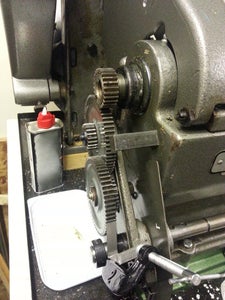

On an ML10 it is not possible to increase the number of engraved lines (ie decrease the angle between them) by a large amount. With the standard set of change-wheels 75 divisions is probably the maximum sensible number. (A larger number of divisions would need gearwheel pairs on both studs on the banjo, with the primary pair having a small gearwheel in contact with the 25T spindle gear, and a larger gearwheel linked to it on the primary stud. This combination is not possible, because the 25T spindle gear would foul on the larger gearwheel).
In fact, the simplest way (possibly the only sensible way) of changing the number of lines is to have the gearwheels positioned as shown in the photos. The 25T spindle gear drives through an idler gearwheel (any number of teeth) onto the secondary stud which has a 25T gearwheel in contact with the idler and a 50T (say) gearwheel linked to it on the stud. This combination gives 50 divisions. The number of teeth gives the number of divisions. Ie 50T gives 50 divisions, 40T gives 40 divisions, etc. It seems to me that the useful gears from the standard set are 20, 30, 40, 50, 60, 70 (I can't see much use for the others 21, 35, 45, 55, 65, 75 except for their divisibility when producing small numbers of engraved lines - see below).

Using the bullwheel (the large gearwheel just behind the chuck - used in conjunction with the backgear to make the lathe rotate very slowly) is evidently another solution. For the Myford ML10 the bullwheel has 65 teeth and the backgear cluster (which engages with it) is a combination 21T/56T gearwheel - neither of these look much use for the task in hand. However, in other machines, this could be very useful (eg a 60T bullwheel could be used for 2, 3, 4, 5, 6, 10, 12, and 15 divisions).
