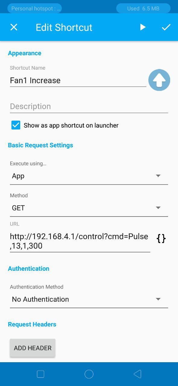

Step 6: Configuring Wemos D1 Mini
For Wifi configuration I have used EspEasy firmware which is are fine piece of work.
Basically pins D6 and D7 generates the pulse for 300ms to the base of transistor
Use this link and burn the firmware to Wemos D1 Mini.
Using this link we can Increase http://192.168.4.1/control?cmd=Pulse,13,1,300
Using this link we can Decrease http://192.168.4.1/control?cmd=Pulse,12,1,300
The above links will work right after burning firmware to Wemos
Later if Access Point information is added to Espeasy, make sure to use the desiganated IP address in the place of 192.168.4.1 in the above link.

Step 7: Using Android App to Control
https://play.google.com/store/apps/details?id=ch.rmy.android.http_shortcuts
HTTP Shortcuts android app allows to control the fan speed as shown in attached pictures.
