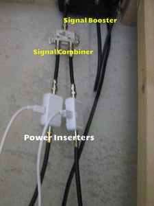

As I mentioned earlier, I already had a 2nd antenna. In order to improve its performance, I added a Preamplifier to it. The preamplifier is mounted up by the antenna. A short coax from the antenna goes into the preamplifier and a coax leaves the preamplifier and goes to your receivers. In my application, I have a coax from each antenna / preamplifier system go down to the basement.
Step 4: Final Connections
In the Basement there is a cable from each of the antenna systems. Each system requires a Power Inserter. This device provides power to the Preamplifier. I also have a signal combiner that will combine the signals from the 2 antenna systems into one coax cable. I have done some research and there seem to be a lot of opinions on these devices. What worked for me was a device specifically made to be a signal combiner. It was around $8.00 from Amazon. I had an existing Power Booster that I used. The schematic diagram shows the final layout of my system. I tried the Signal combiner and Preamplifier in different configurations, but the final setup shown on the diagram worked well for me.

With the 2nd antenna, we went from 19 to 35 channels. The addition of the terminating caps / resistors cleared up the reception on a couple of the channels. I am really satisfied with how this turned out and I hope you have the same success!
