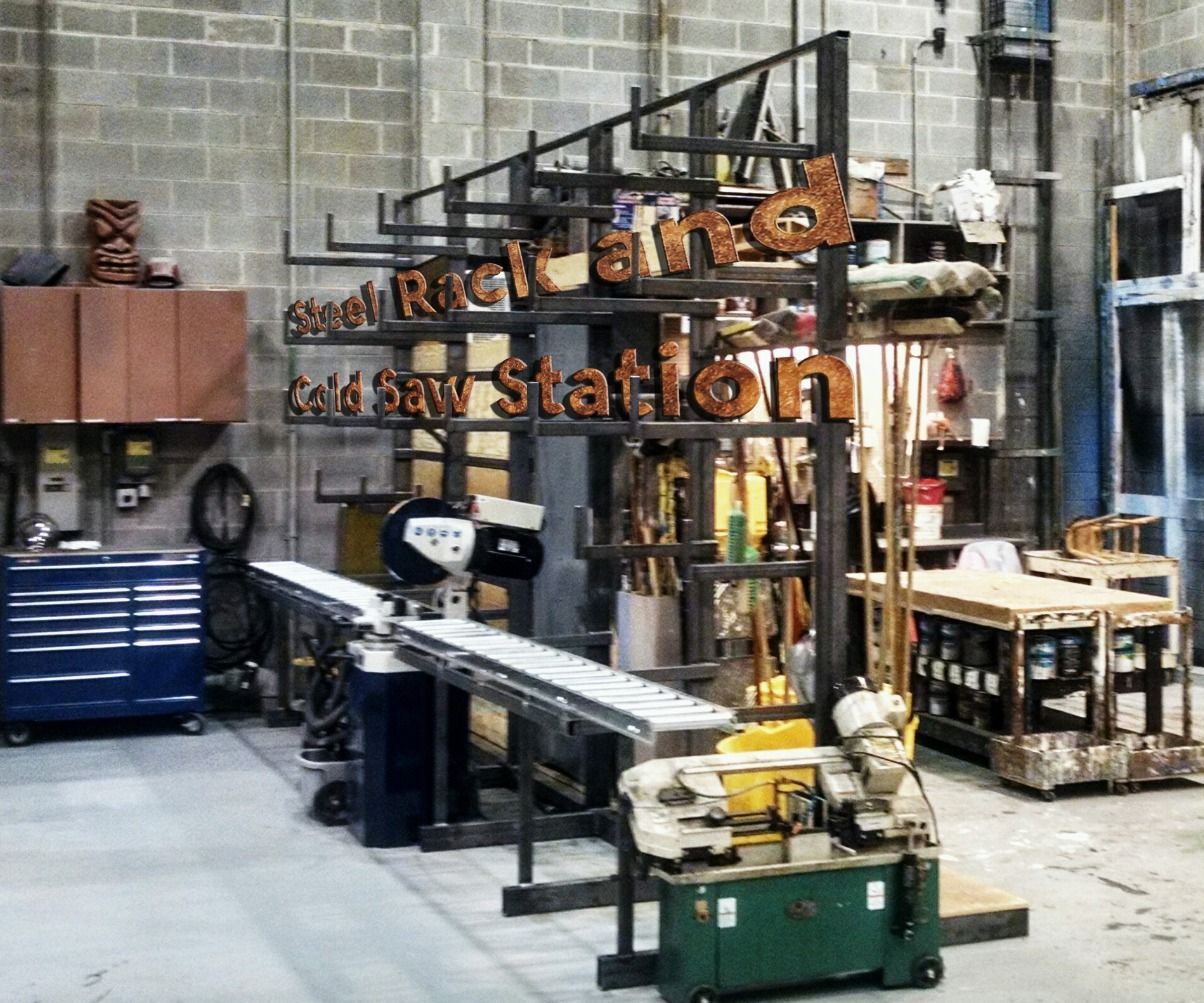

I have access to a cold cut saw which makes quick accurate work of this thin gauge tube. A cold saw uses a HSS (high speed steel) blade and coolant to chisel its way through material. The blade spins at a low rpm (40-100 RPM) compared to a much faster rpm of an abrasive saw.
